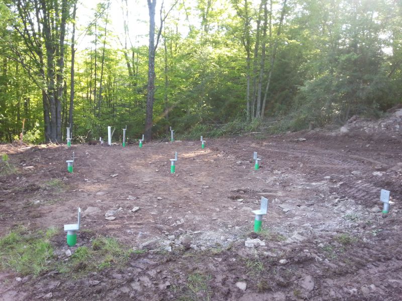

I've attached (I think) a picture of this past weekend's work. I (along with my wife's uncle) cleared lots of trees, graded the area for the cabin, built up a berm uphill from the cabin, extended the sewer line above grade, installed a conduit to fish the future water line up through, improved the driveway up to the land and installed the helical piles.
The cabin will be supported by Techno Metal Post helical piles and be 18" above grade to the bottom of the floor joists. We'll insulate the floor joists with fiberglass batts and secure 2" rigid foam to the bottoms of the joists. The foam will be protected from rodents by 1/2" plywood screwed to the bottoms.
