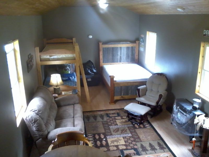

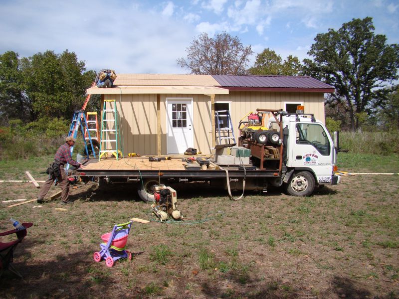

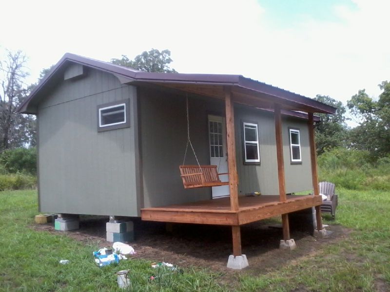

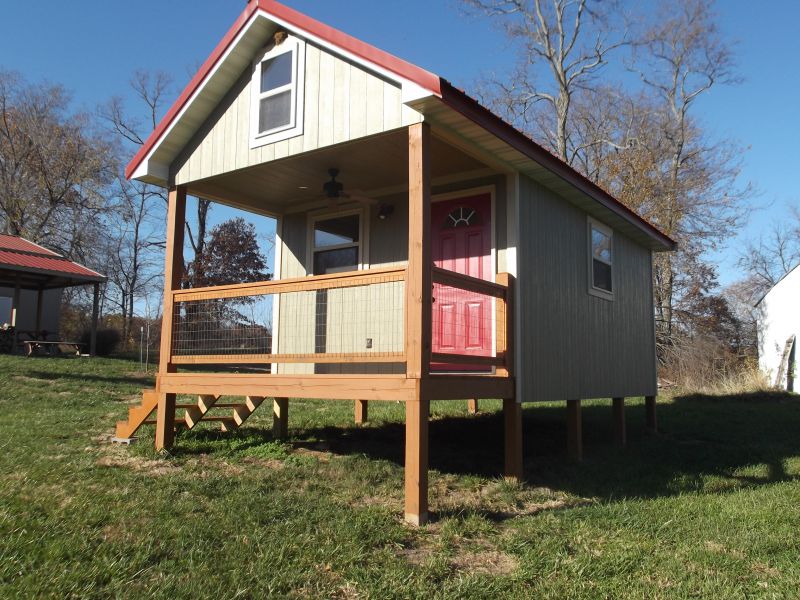

I think you can be very happy with a shed to cabin conversion. Do shop around to look at the construction methods used. They will vary a lot. I suggest buying from an independant shed builder as opposed to the box store. They will be much more flexible to build it to your request. In the end we went with a company that allowed us to provide our own doors and windows, which they installed during the build. They also built in overhangs trimmed out our window jambs inside and other special request at no extra costs. In the end with the distance we have to travel and the number of trips it has saved, not to mention we got to begin enjoying it from the first weekend I don't feel it cost me much to buy the shell. 026_2.JPG
