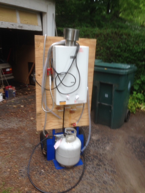

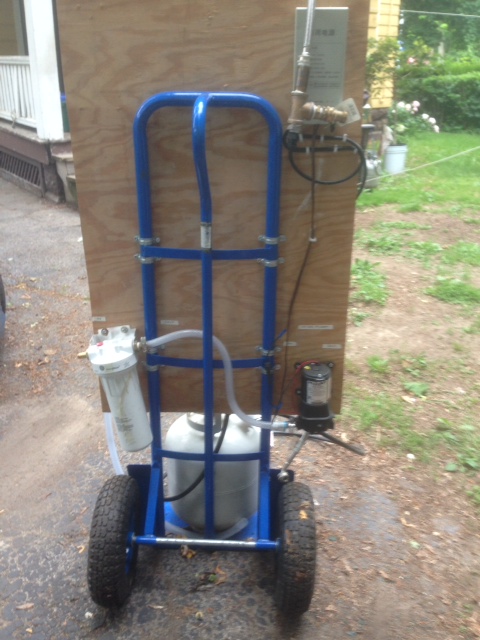

  The ecotemps work great.  I built mine onto a board attached to a two wheel dolly.  The pump and filters are also on this board and the LP gas sit on the base.  It hooks to the main water lines via braided hose that has a Pex fitting on one end and a hose collar on the other.  This hooks to boiler valves.  I pull water from 55 gallon food grade plastic drums.

# Posted: 4 Jun 2014 09:20pm - Edited by: MO Cabin
  You dont happen to have any pictures,  do you?

# Posted: 9 Jun 2014 12:31pm
  MO Cabin Sorry my replay took so long been behind at work.  I'm just bringing my set up back to my cabin as I remove it for winter and put it in storage.  I use a Flojet pump as these don't need a accumalator and they work pretty good as a on demand pump everytime a tap is open.  The box on the upper right corner of the board is my 110 volt AC to 12 volt DC transformer.  I can run this setup off a battery should I choose but I'm quite fortunate to have 110 volt power considering how far my cabin is in the woods.  The hot water heater is a demand Ecotemp L10.  These work great.  The pump has a Tee connection before the hot water tank so I have a cold supply.

  Thanks for the pic.  I think I am going to try something like that.  But I hqve been a lot more research on pex and I do not think I will be able to use it.  I am planning water collection and then using chlorine to keep out the funk, and it turns out that pex and chlorine are not a good match.  Now I am leaning toward galvanized steel, especially after I go a look at your fancy hot water dolly.
