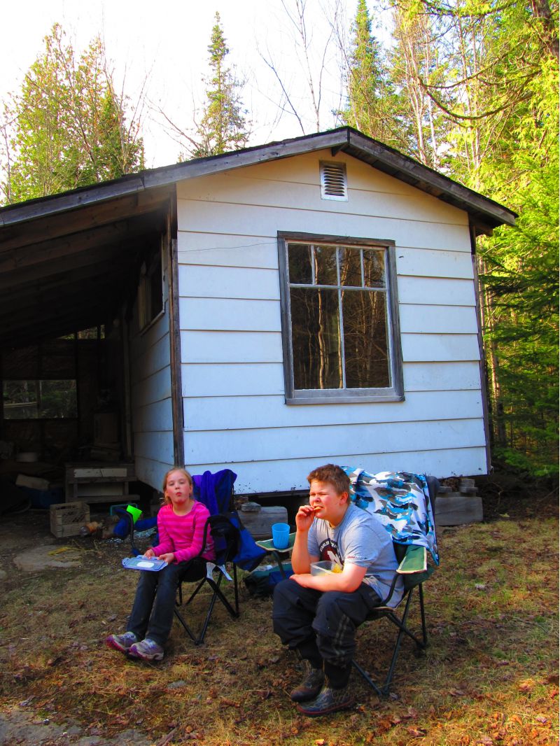

  So we've started looking at what needs to be done to our cabin so we can actually use it... and essentially, we need to rip everything out but the bare bones. And even then, we don't know what shape those are in (although everything looks straight and solid). The risers under the camp need to be replaced. It needs a new roof. Because the old roof leaked and got everything thoroughly wet and mouldy, we need to replace the floors and rip out the interior walls as well as the ceiling. There is asbestos in those walls. Some windows are shattered. I could go on.
  We've been looking at pre-fab buildings of the same size and thinking we might be better off replacing the old cabin with a completely new building. Consider a) that we don't have the time or the skills to do most of the renovating ourselves except for some finish work so that means $$$$ and b) we aren't crazy about the location of this cabin and have found the perfect spot to put a new one. What would you do? Is it worth investing in an older cabin or not? Here's a picture for those of you who didn't see my other threads.

  If it was me, I would build or buy new and use this as a storage shed or rip it down and burn.

  Is there sentimental reason to keep it?  Could you get by with saving a door or window to remember it by?
  Could you repurpose it as a shed and let it live a little shabby?
  For the time you will spend, which could be spent doing other fun things at your property I say get the prefab - if it gets you what you want.
  I am all for keeping things when possible, but if it means tearing most of it out and the foundation and floor isn't good then it may be cheaper, faster and less stressful to start fresh.  I hate to say.

  I tried to restore an old place and gave up and rebuilt new.  More money will be spent and you will have a renovated old cabin.  You will be much happier in the long run and will have the location of your choice - just do it.  Asbestos - don't even go there.

  I have a similar situation: dilapidated, old stick-built cabin (home to wood rat squatters for 30 years) on beautiful land. For most of my 9 years of ownership, I planned to shore-up the tipping post foundation and to try straightening and leveling the place out. But being a precision carpenter, I've come to the conclusion that trying to put order to this chaos would drive me crazy, and cost even more than just building new from scratch. (Plus, I've lost patience with the rats.) My plan, now, is to dismantle the old cabin, salvaging what good lumber I can (the previous owner, for some reason, built the uninsulated structure's walls out of 2X8's), and to rebuild on a solid foundation in the same location. I think you'd be best advised to build new, as well. The asbestos situation is a sticky one. If you can afford it, have professionals remove the hazard. Otherwise, learn all you can about the safe removal of this material, and do the job yourself. With the asbestos out of there, then dismantle and preferably bury the remnants of the old cabin. It's hard to get completely free of asbestos, and the safest route is to remove or bury anything that could possibly have trace amounts of the material on it. If you have gorgeous land, and a clear vision of the new cabin you'd like to build, then enthusiasm for these things can help you through the challenge of abating the asbestos. Wishing you success in realizing the positive vision for your property!

  Hey all, thanks sooooo much for all your replies! They are a huge help as the consensus is REBUILD!
  TheCabinCalls - we just bought the property so there is no sentimental value. We did not even know there was a cabin on it when we made an offer on it. It has no value.
  Just - we don't need permits to built a cabin here. Remote location, no laws on buildings this size here.
  Everyone else, I think we will just leave this cabin where it is and use it as storage, maybe even a decoy for break-ins. We have an entirely different location in mind for our re-build and it will have a gorgeous, panoramic view. It is in a remote location, so hiring someone to go out there and remove the asbestos professionally would probably be prohibitive. We are definitely NOT qualified to do it oursevles. For now, it will stay there undisturbed until it falls down by itself and we'll figure out what to do then.
  In the end, I have to agree that it will be a better investment to build new. Not to mention the excitement of having a new cabin in a new location! We expect it will take a couple of years to get organized and start building but we feel it will be worth the wait. An old neighbor of ours builds baby barns so we're going to make inquiries... the only limitation is that to haul anything up there is tricky. We are not carpenters so building on site is daunting... we are exploring options.
