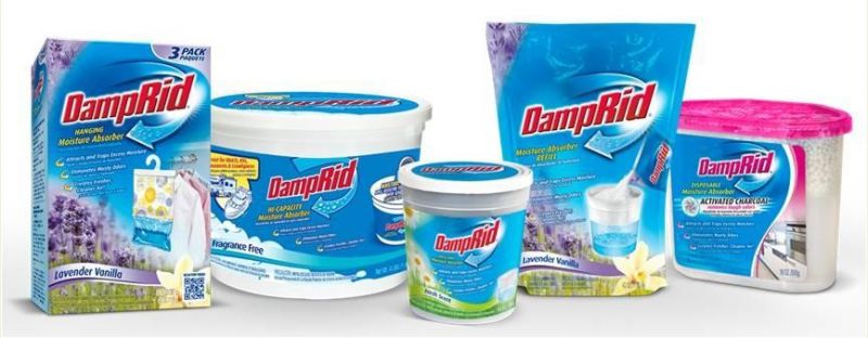

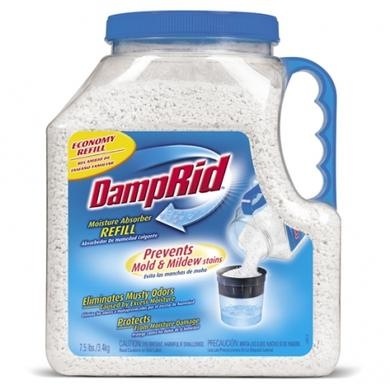

# Posted: 22 Jun 2014 11:19am
  Here is a product I use in my basement and put in my boat at the end of the season to remove moisture and prevent mildew and musty smells. It works for me. I don't use it in our cabin because we don't have a problem with these issues.
