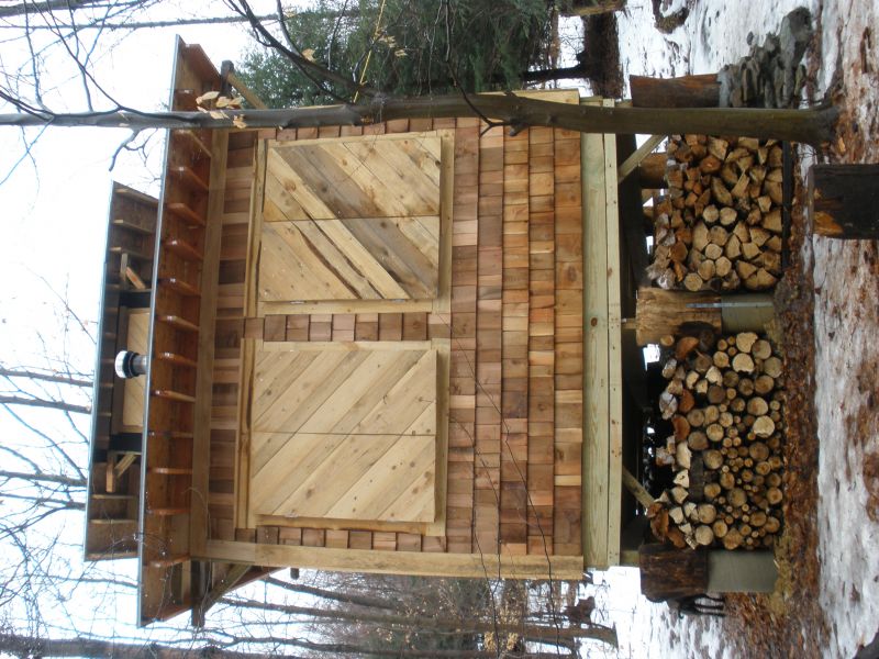

This is the best pic i could find of my shutters
They are two layer of 1x6 rough sawn lumber, cross laid and glued and screwed together.
I tested one and they do stop .22 bullets and birdshot. The pair over the sliding glass door were so heavy it took four of us to hang them.
Only problem is that i mounted the hinges on the inside for security but then they won't open to 180 degrees and lay flat against the building.
Been thinking about remounting them with the hinges exposed with one way screws.
MikeOnBike
# Posted: 18 May 2010 10:52pm
I think you can get around the 180deg open issue if you trim the window out at least the thickness of the shutter. Mount the hinge through the trim and then you will have enough relief for the shutter to open.
fasenuff
# Posted: 20 May 2010 07:39pm
There are also a number of offset double hinges that would do the trick.
