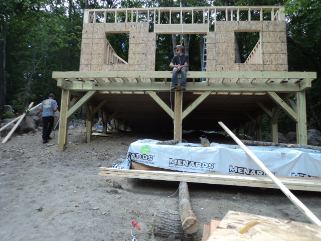

I agree with him, In the long run, concrete can't resist frost. The old timers would drill igneous rock and let water break it in the winter. Cement block is very weak compared to solid rock, filled or not.
The best is frost posts with good drainage, coupled with large beams all tied together. Like this. These actually go to bedrock, best
