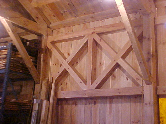

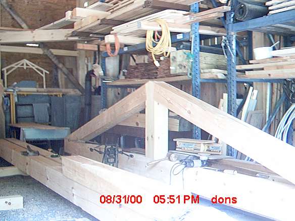

  Timberframe is wood connected heavy timber, mortise and tennon joints with wooden pegs primarily. Post and beam is heavy timber with steel connections, metal plates and bolts mostly.  Neither is particularly difficult, just different than conventional framing.  If it's a single story... well, I'm shooting from the hip, but I suspect in red maple for the frame it could be 6x6 posts spaced around 8' on center with a row of 6x8 beams on top to carry the rafters. If the wall sheathing boards are applied diagonally or if there is plywood or osb sheathing then there wouldn't need to be structural braces. The old dutch style was to frame on about 4' centers which has some advantages, if you saw the sheathing at about 5/4 thick it can span that distance. For the walls I think it would be easier or at least less material to saw out than with log. The roof is going to be the same on either. Not being able to saw a 20' rafter tie presents a possible challange depending on how you plan to do the roof and the interior wall layout.
  Attached is a pic of one way of doing bracing in a bay section when the sheathing is not diagonal. This was actually just built up and lagged together, not really purist but it works well and I thought it looked good.
  Second shot is a 18' truss in timberframe at 4/12 pitch. It has an 18' continuous bottom chord but there's more than one way build a roof.
