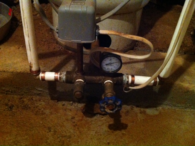

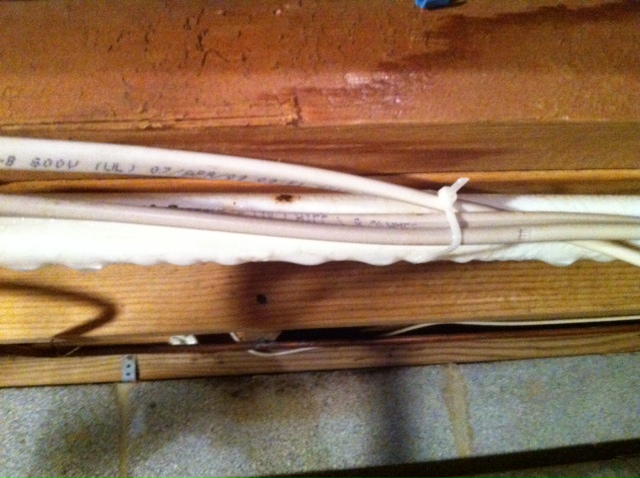

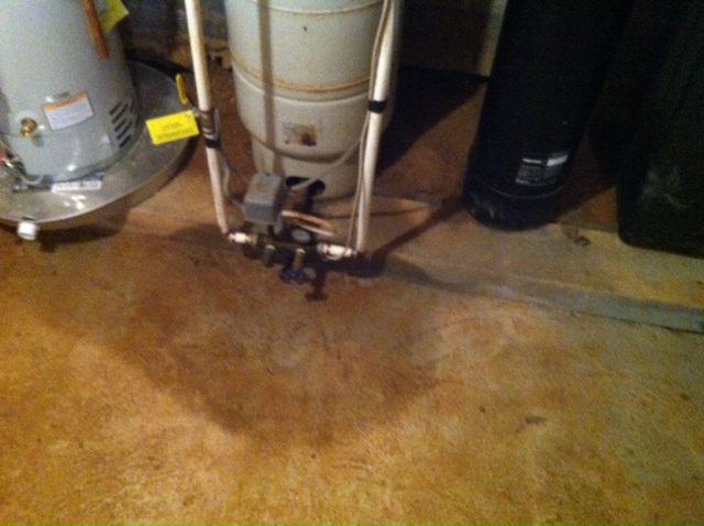

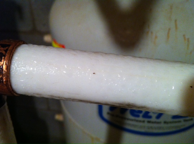

  My cabin's crawl space is starting to grow mold.  Today I went into the crawl space and noticed that all the pipes coming from the well have condensation all over them.   Is this normal when the well water is very cold, and it's hot outside?
  I also noticed that the concrete is wet, just under the well valves...    I could not tell if there was an explicit leak...   or if the condensation is just dripping off the pipes.   In the case where the pipes run vertically, the condensation seems to run down the pipes and on to the floor.

  Most likely you have condensation due to high humidity and cold pipes.
  Is the crawlspace floor concrete all over?  Was a heavy plastic sheet placed on the ground before concrete was placed?
  What sort of ventilation does the crawl space have?
  Any insulated crawl space walls or floor above?

  Hi MtnDon.    The crawlspace has about 25% of the floor in concrete and the rest in dirt/exposed bedrock.
  The concrete area has a hot water heater, well water tank, water softener, and a refrigerator on it.

  It is condensation. We are in a period of high dew points right now and it is easy at those times for a surface such as those in cool crawlspaces to be cooler than the dew point. When you bring in hot humid air into a cool space the relative humidity climbs higher as the air cools and the dew point rises. You can see the condensation on an impervious surface such as a pipe. What is possibly more concerning is whether the wood is above or below dew point. Wood is hygroscopic, it absorbs water readily so you don't neccessarily see it sweat but its' moisture content may be rising into the decay zone. If you have access to a moisture meter, either personally, or a cabinetmaker, or home inspector, it might be worth checking. If its getting into the 20%'s or above you're in trouble.
  There are a few ways to alter the equation. Seal the floor, caulks or mastics stick to plastic and concrete. Heat the space, raising surfaces above dewpoint and lowering the RH and dewpoint. Dehumidify the space, again this warms surfaces and the air, lowering the RH while lowering the dewpoint.
