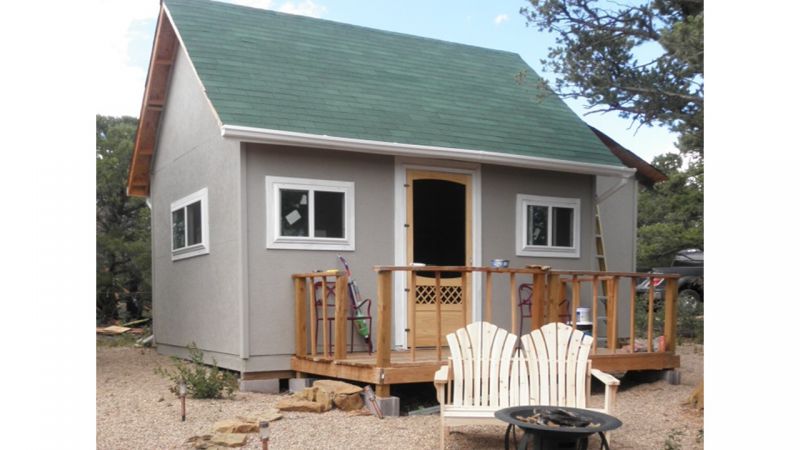

# Posted: 20 Jul 2014 09:38pm
In the words of my nephew, "Geez Uncle Jeff, just build some ladders the right length and screw them into the gable truss." Once I thought about it, that was a pretty simple and accurate explanation. Worked on our Colorado cabin. Jeff

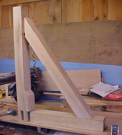

You will probably see many examples of craftsman roof brackets that extend beyond the overhang as a decorative detail. Keep them behind the fascia to avoid rot and tracking water back in toward the wall. I agree, while the roofing is off running some straps back to tie to the roof plane will make them stronger.
Attached is a pic of a bracket for a window cover, upside down but gives a basic idea of how to make a strong bracket. These were out of a rot resistant wood.
