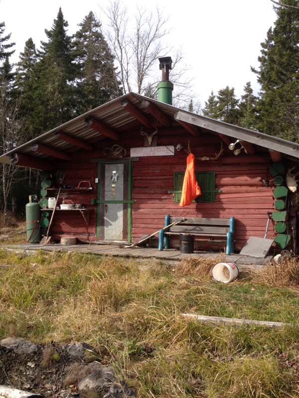

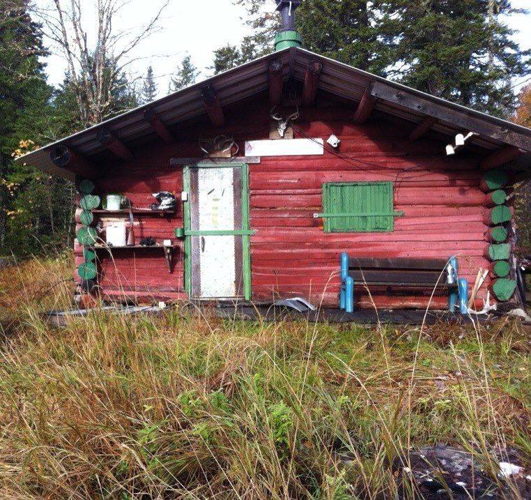

Hi everyone, I'm looking for some advice. I have a 80 year old log cabin in Northern New Brunswick which needs some attention. The logs are insulated with oakum in some sections and showing gaps where the oakum has fallen out/missing in other sections. I was considering chinking the entire structure however the cost seems outrageous for the amount of time I actually spend there (2-3 trips a year). I was considering using backer rod between the logs followed by spray foam insulation and then a 3" strip of wood covering the gap between the logs. Just wondering if anyone has any suggestions.

Thanks everyone for the great advice, I should have started here. Although it's 80 years old my camp is still in pretty good shape. I replaced the bottom logs a few years ago, new roof and floor last year. My main issue now is to tighten it up between the logs, last year It was just to cold! I think I'll go with the backer rod followed by the mortar mix over it. Cost wise I think it's the best option. I'll pass along some pics!
Nirky
# Posted: 23 Jul 2014 08:11pm
Cool plan. It's going to look like a classic log cabin once again after you remove those gap covering boards and properly chink. The nail length should be 2 1/2" or longer for those larger gaps.

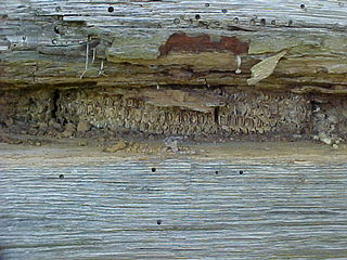

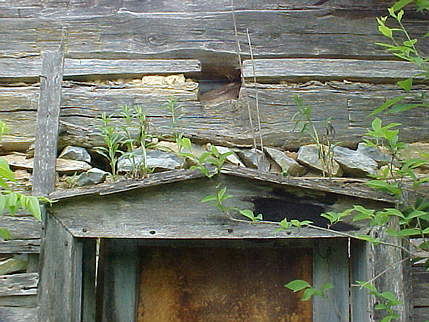

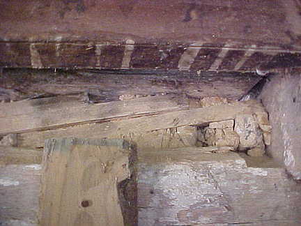

cob and daub (cobs and clay)
chipNdip (chestnut chips and lime mortar)
Limestone flakes, lime mortar & chestnut splits
