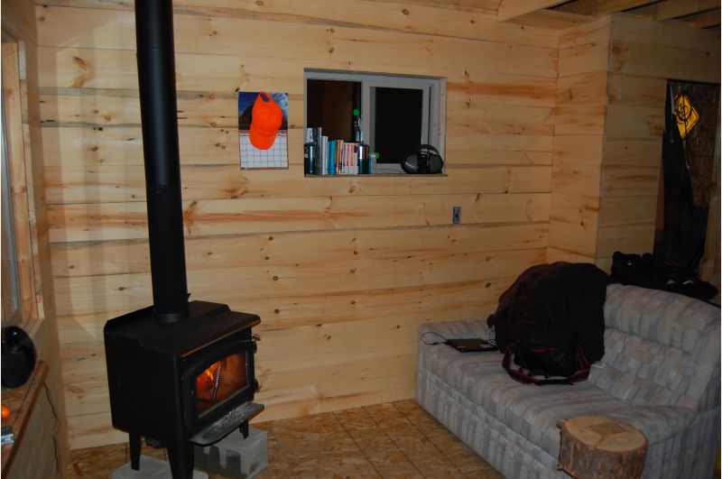

I used all rough cut 1x8. Board and batton outside and horizontal on the walls inside. 2x4 walls, full vapor barrier and insulation everywhere. I had them stickered and under cover for 6 months before using them. Due to shrinkage and the nature of rough cut there are gaps and different widths and thickness's but I think it looks fine, I wanted it rustic. There is very little if any air movement through the walls. Double pane windows, 14x16 foot print. Once it's warm in there it takes VERY little heat to keep it that way right into the single digits.
Thanks, Geno
Rough cut 1x8 walls
Rough cut 1x8 walls
