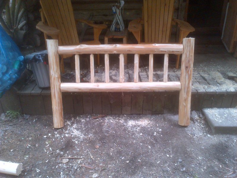

I made a jig to do that using my router. If you google logman tenon cutter you will see a similar device which is what I based mine on. I can make any size tenon I want and use long pieces of lumber up to 8" diameter. I used it to make my headboard for my bed. Works great and I plan to use it aa lot more. I'm in the process of making a log cabin sauna and I want to do a porch with railings using the tenon maker. Here is a pic of my headboard.

Well I guess my blackberry isn't going to let me show you the pic. But google logman and you will see what that fella did and I made essentially the same thing.

Oh I guess it did let me! If you are interested I'll take pics of my jig and post it for you
