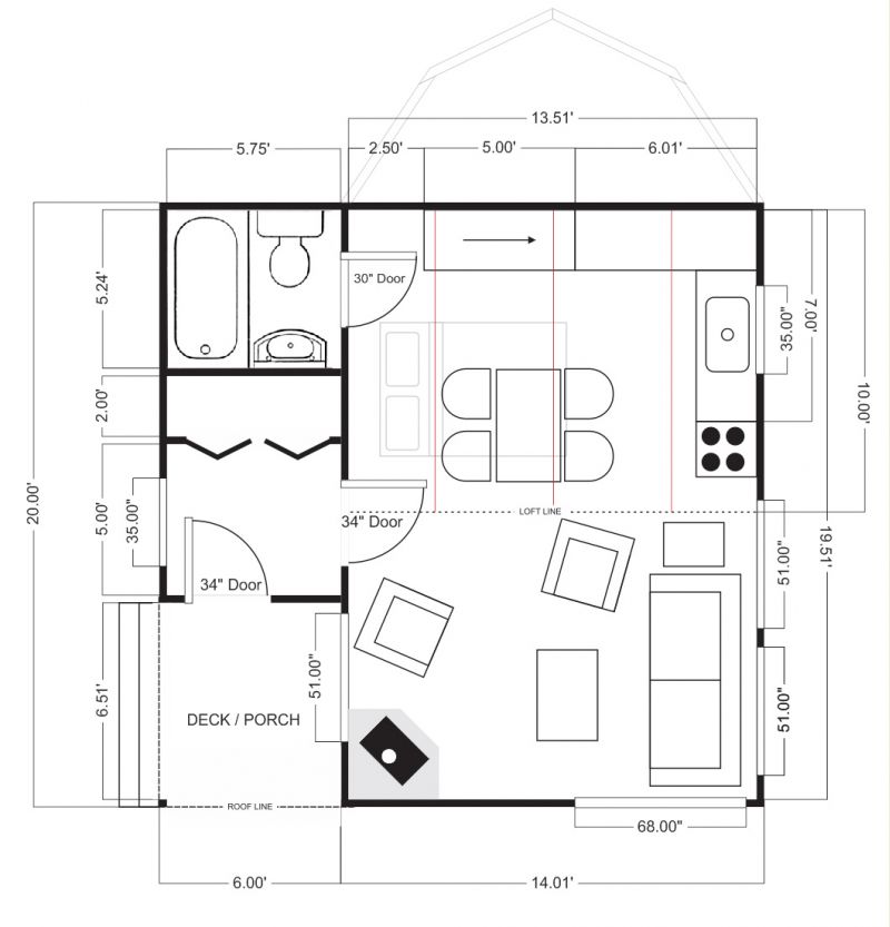

# Posted: 10 Sep 2014 01:03pm
We've been working on the floorplan. We're going to go with a 14x20 cabin with gambrel roof and a 6' porch on the 20' side.
Thought I'd post the floor plan for kicks and giggles...
