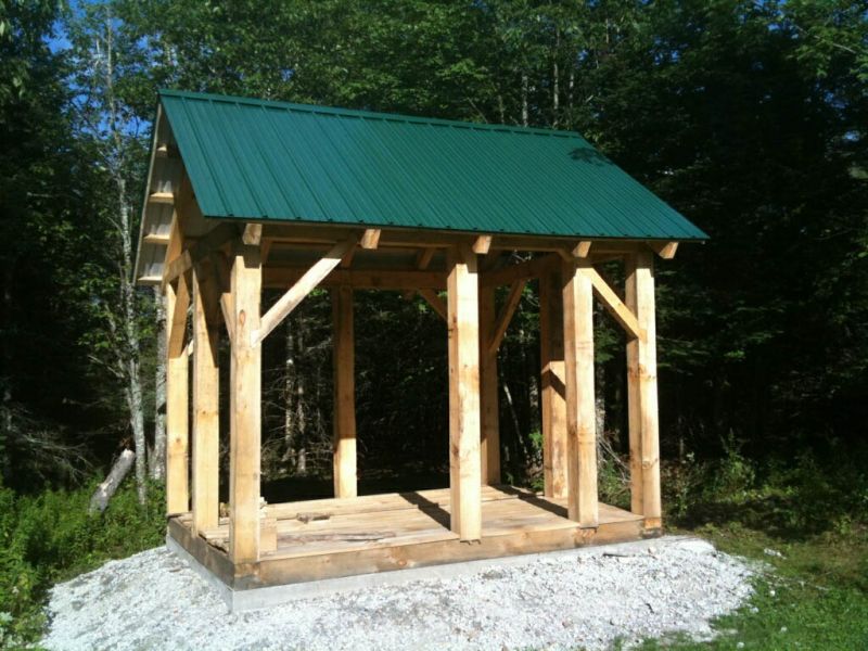

thanks for the replys. I ended up with a hybrid mix. I poured a foundation, but made it about 26 inches off the ground.
weecabin
# Posted: 19 Aug 2010 03:50pm
here is where we are on our cabin so far...
