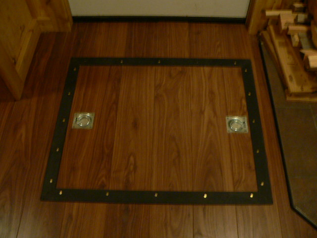

  Stemwall is 2 feet, not sure how thick the footing, suspect 8" min. Backfilled with about 8" of stemwall showing, just above the vents. Underside have a layer of gravel, then a black vapor barrier. Low area has a drain tile added for later if there was ever a water leak from plumbing. Very dry area, 300+ days of sunshine a year, but does get cold. Was all signed off my the inspector, met code. No drain tile used around perimeter at all, just back filled.
  I did not install outside crawl access, so I could have extra storage. I use a hatch door in the floor just inside the entry door.
  56 feet total. I did the foundation back in 2008.
Tarmetto
# Posted: 4 Sep 2014 08:20pm
  I like the hatch door idea!

 Quoting: Tarmetto I like the hatch door idea!
  I wanted secure storage, but it also keep assessors and inspectors from poking under there looking for options like water, electrical, gas.
  But security (secure storage) was my main reason.
Tarmetto
