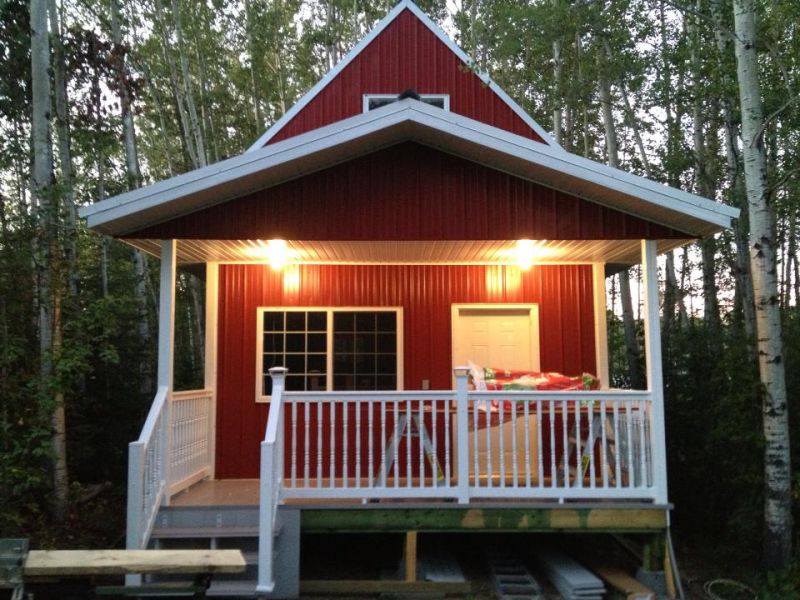

I have built a 16 X 30 Cabin (6 ft front deck).
But now I need to anchor it for the inspection.
It is built on pier blocks sitting on concrete sidewalk blocks. Area was leveled with gravel first. Soil below starts sandy but becomes dense clay pretty quick.
The cabin is kind of tucked in to the trees, so there isn't a lot of room on the sides. So anchors will probably need to be put in by hand.

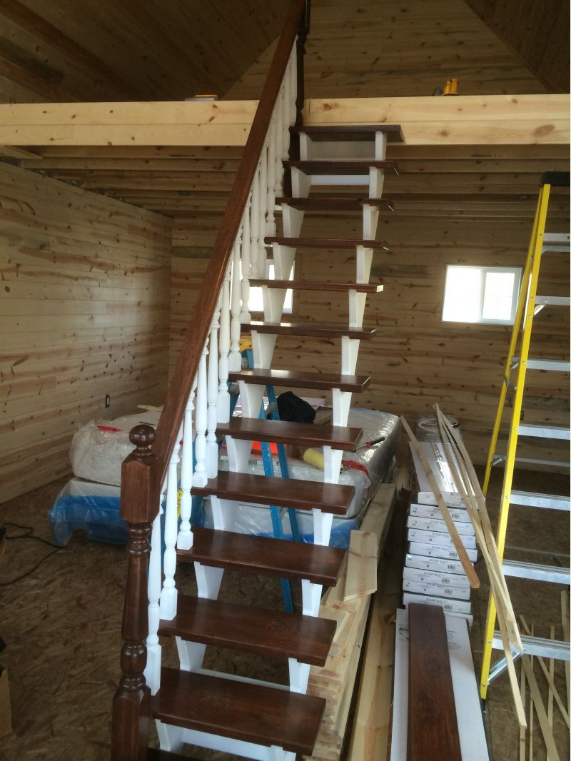

The really trick thing about the cabin is the stairs to the loft inside. They are on hinges and use gas struts to raise when not in use. I still have to order the custom gas struts though.
tkittlitz
# Posted: 28 Aug 2014 05:10pm
Some stair pics

Nice staircase

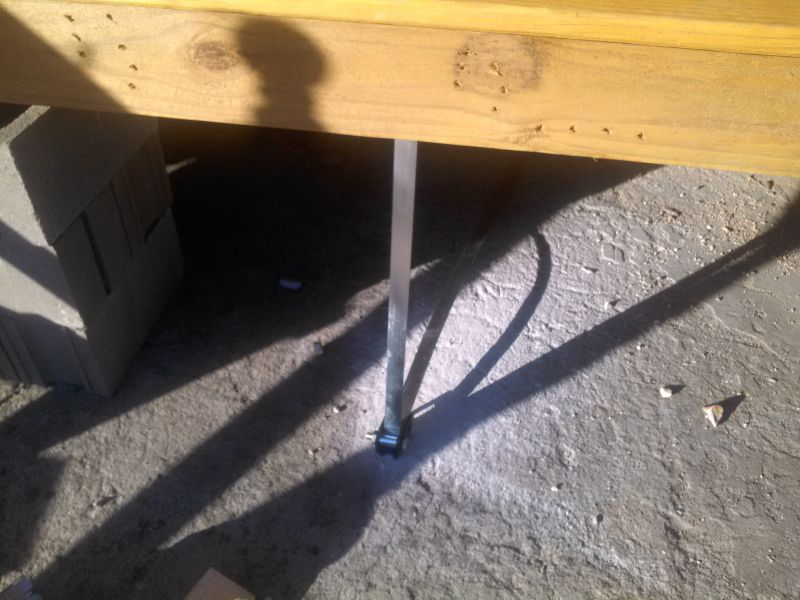

My cabin sits on a concrete slab then on cinder block piers 24 inches tall. I used mobile home straps every eight feet. the straps i got were designed to hook to the I beam on a mobile home, so what I did was drill a 1/2 hole in the center and lag bolted it to the wooden skids went over the top of the skids and used expansion bolts in drilled holes in the concrete. they have tie downs that screw into the ground that you hook the straps to.

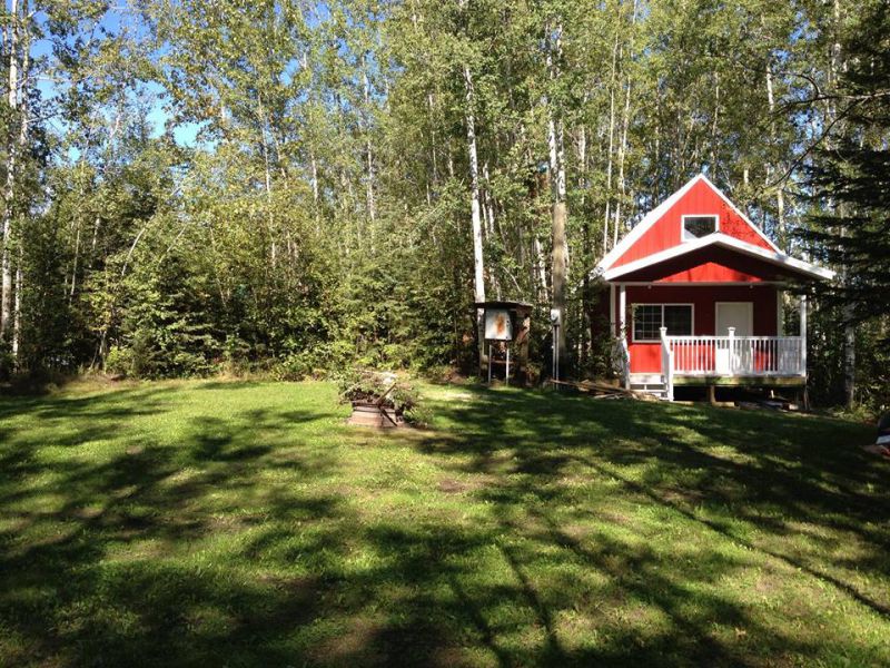

Cabin is near Whitecourt - Lone Pine Area
Inspection went good and cleared. We ended up using about 40 arrow head style anchors that we sunk in to the ground with a jack hammer. Then the steel cable gets attached to cabin with bolts and tightened down. Worked pretty well.
