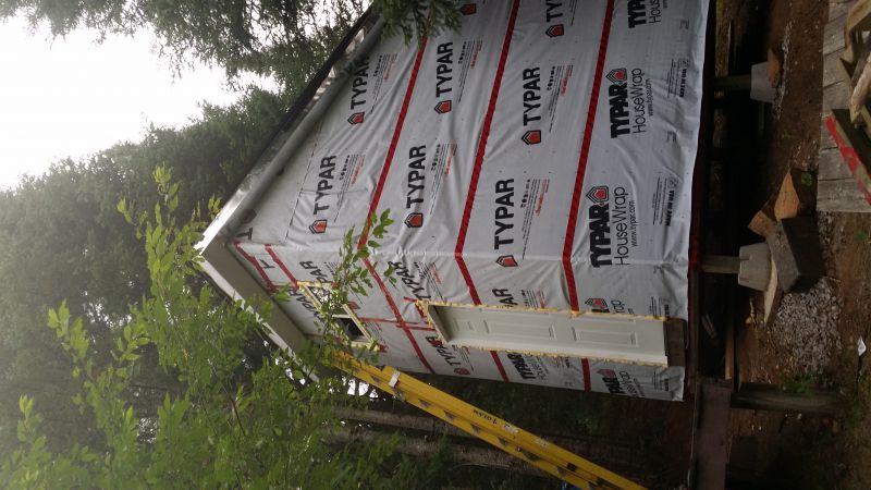

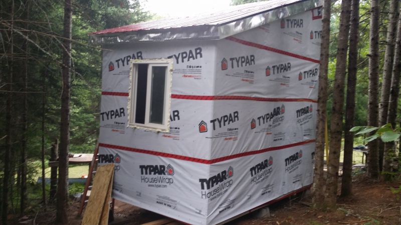

  Built a cabin this year about 45 mins from Bancroft.
  I have had the house wrap exposed for about 8 weeks now and no leaks or anything, but I am now ready to do my siding (I need 400 sq feet essentially, so have to purchase about 450 sq ft). I know there are some mills and lumber yards around the Bancroft area. Does anyone have any suggestions on type of wood (cost is an issue as I don't want to spend more than about $500 on siding)? types of siding? vertical vs horizontal? And does anyone have places in my region that you would recommend using?
  Any help would be appreciated immensely. As a first timer doing this I love getting to see this dream come alive, as well as being able to learn so much along the way.  Backside (Don't mind the fascia, replacing)
  |   Front

  Is fire a threat in your area? If so I suggest Hardi siding, made of cementious materials. If fire is not a threat, you might check with local small sawmills, you might find a good deal. Cedar is good just because it is resistant to rot. But you can use anything. All siding has to do is protect the underlayment so it stays waterproof. The siding itself can leak a bit toward the underlayment, so long as the water can get to the bottom and get out.
  You should flash the top of your window with flashing that overlaps the window fin and under laps the house wrap.
# Posted: 22 Sep 2014 06:29pm
  BLDG took the words rigth out of my mouth. Do you have OSB under that wrap, or jujst studs? If its studs, you need a sheet siding. If its sheeted under the wrap, then you can use the planking and those are much easier for a guy going ti by himself. You can get hardi siding in planks too. But warning, cement siding reqwuires a special blade (diamond) and wear a face mask, the dust is horrible and it can cause a debilitating lung disease known as silicosis. And nailing it can be tricky, its like sheetrock, you dont want to bust the skin or you lose the strength of what little there is. (reason it must use an underlayment like OSB)

  BLDG - Fire is not really an issue with the area I am in. I have been in contact with a couple local sawmills, just am looking to see what others thought. I will be flashing the windows when I do the siding, which will be the weekend after next.
  Toyota - I do have OSB underneath that house wrap. I am really leaning more towards wood from a local mill I believe. The cost of the cement siding was going to be almost twice what it looks like I will be able to get from a local mill in the area. Luckily, in my area, there is quite a bit of logging happening.
