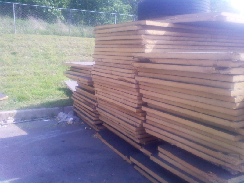

  I have a 12x16 with 2x8 floor joist up on skids.Currently I dont have any insulation in floor but i do have a large amount of 2" 4x8 sheets of polyiso rigid foam.My question is would it be okay to install the foam underneath the cabin across the joist in full sheets and taping the seams instead of cutting it to fit between them?
