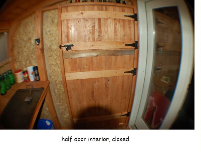

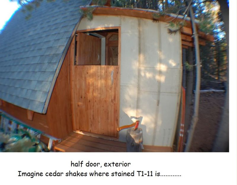

Hi there
Two of my last three doors were built with 2x2s. Folks seem to like 'em. More importantly, I like 'em.
Quite rustic and functional.
Just stagger drill/nail or screw 'em in series to the width desired. Use 1x cross members, apply stain/sealant, hinges, latches.

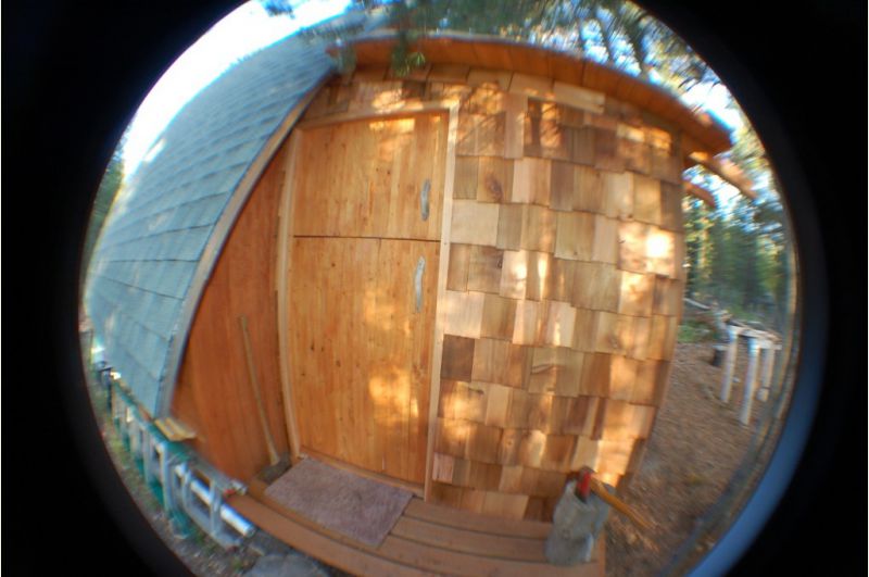

# Posted: 4 Oct 2014 03:22pm
couple more pix

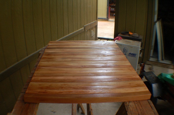

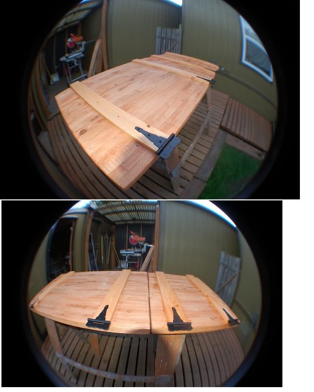

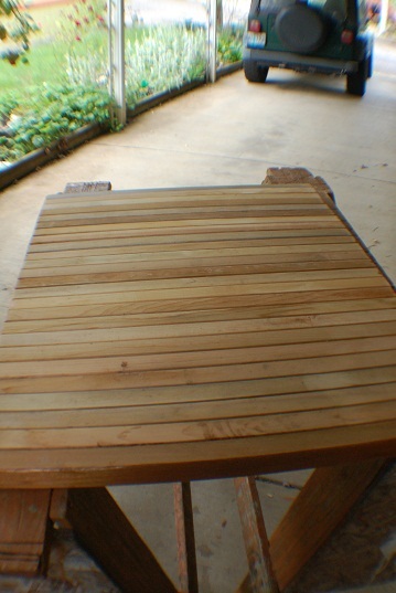

I've built them from rough cut 2 x 8's. I measure the entire width of the door, divide by the number of boards, and rip them so they are all the same width. I then groove the edges and rip splines that fit, caulk the edges, grooves and splines, and clamp them together. I drill them and use 3/8" carriage bolts that have been blackened, and 2x 6 or 8 cross braces and a Z diagonal brace. I get square nuts to make the bolts look better. The hardware can be blacked with gun cold blue. I make sliding latches from oak, a dowel, and have steel brackets made that are copied from wagon box stake pockets (for adding taller sides on old wood horse drawn wagons). I saw that done in an old fallen down cabin, and salvaged one of the brackets to copy. For handles, wood float handles from the hardware store work well. 1/4" carriage bolts there, as well as for the slider brackets.
I do a small square window in the center board. Caulk the glass to seal it and add rough cut stop cleats inside and out.
You can see most of the important parts here. I use large T hinges from the hardware store, and add a third cleat for a center hinge only on that side of the center Z brace.
I've done similar doors for interiors from 1x6 T&G planed lumber and from 1x rough cut that was splined similarly to my entry doors.
You can kind of see the outside of it in this pic. The door wasn't the focus of the picture intent.
Hey wait, I remembered another place I had pictures. Something I built to sell.
Interior door,
