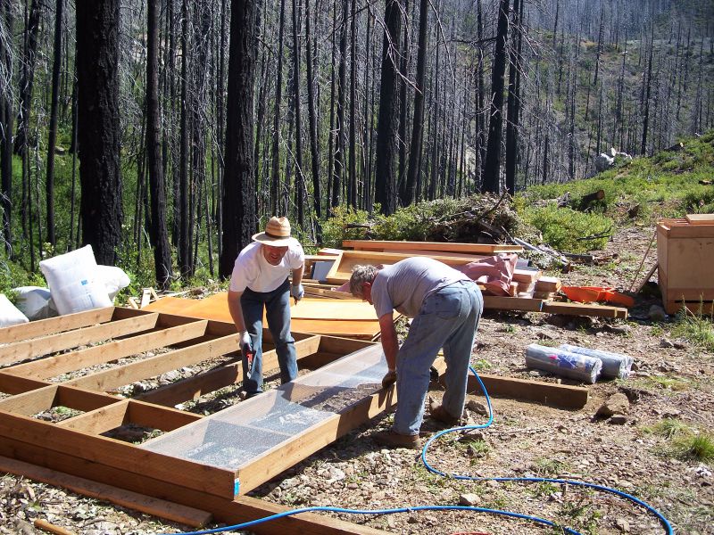

  Easiest way to do it would be to build your floor upside down, layout the floor joist first, plum level and square, then sheet on top with the treated plywood (this will become the bottom), staple on the wire mesh over the entire area and leave enough overhang on each side (12" or better), then flip it over on to your skids, plywood and mesh are now facing down, then insulate between the joist and install interior sub-floor sheeting. Add stud walls, then run the overhanging extra mesh up over the rim joist to just under the siding (attach to bottom wall plate) an inch or so. No way will a varmint get in.
  If your floor is already in place, lay down mesh on floor, then lay down joist and insulate and sheet over again.
  This is the stuff I was speaking off. Not sure if it comes in larger rolls. I speak of the 1/4" stuff. There is also 1/8" too. Its galvanized and can be stapled in place.
  http://www.amazon.com/Inch-Mesh-Tall-Hardware-Cloth/dp/B000BWY7UQ
  Here is Oregon Timber Werks putting down the mesh on their cabin while assembling it.  Varmint Mesh install in flooring
