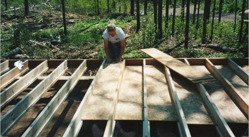

# Posted: 26 Oct 2014 06:32pm - Edited by: OwenChristensen
  You don't need insulation in the floor. The floor will be cold with or without insulation, as heat rises. I insulate floors for about 2% of my customers. I do caution them that their floors will still feel cool. I myself didn't bother on my own and just have indoor outdoor carpet. In the winter, I bank with snow. After all your house has no floor insulation. When we do insulate , we nail 1x2's along the lower edge of each joist then set in OSB panels and fill with fiberglass. I charge $2.00 per sq. ft. for that to my customers. And yes, we're in Northern MN.
