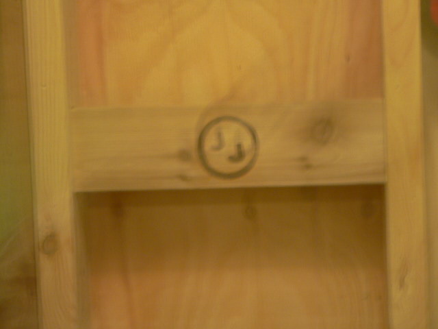

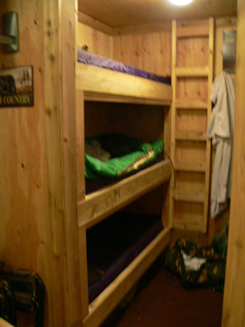

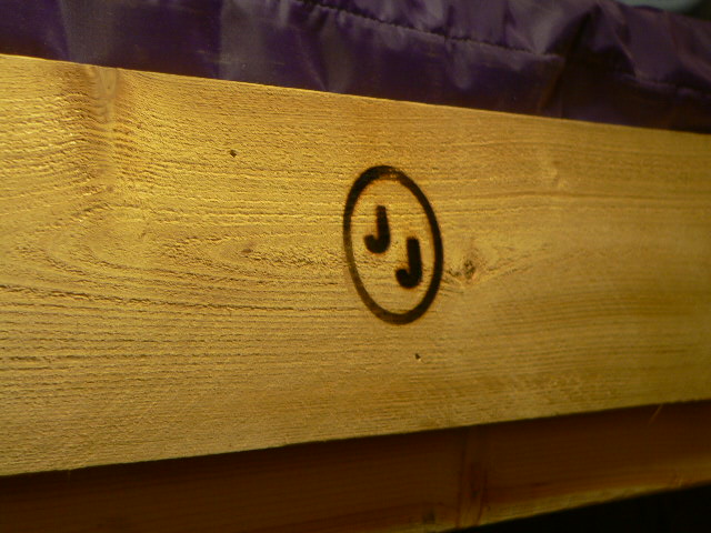

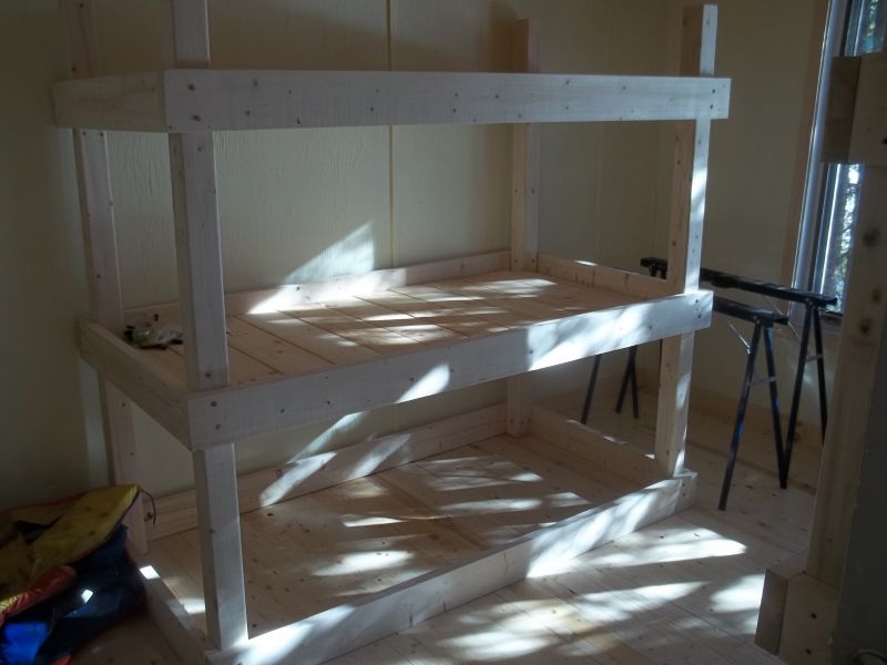

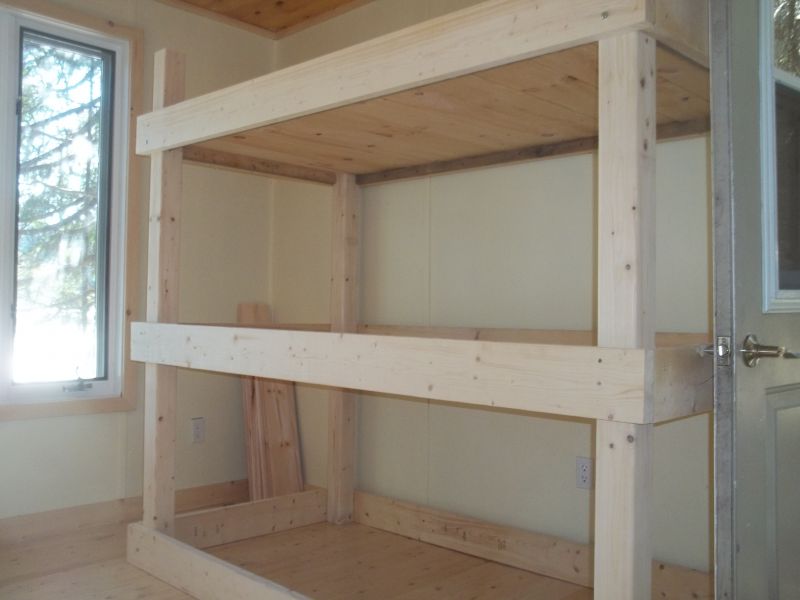

I framed mine in 2X4, then 1/2" plywood, then a gel foam mattress, with a tap light for each. Ladder to reach the top one. I used a 2X8 across the front, trimmed it all out with cedar, then burns in my JJ logo (brand iron)
First bunk is 12" off the floor, then each has 28" of headroom, with full 8 foot ceilings.
I framed them all so the load carried all the way to the floor, nothing relied on nails into the wall for the load. Each bunk was about 6'3" and was a little narrower than the std twin size bed. I trimed the gel foam mattress down on the side, they fit tight into the pockets. Works well.

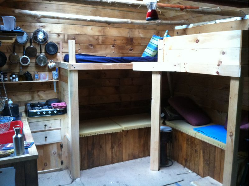

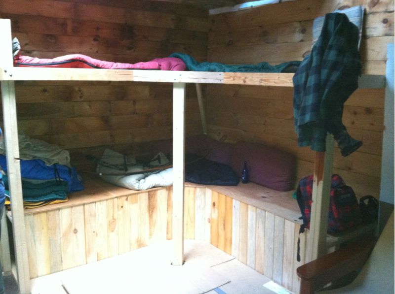

I was limited on space, so i decided to build some funky corner bunks. The tops bunks are about 10 inches wider then the bottom bunks. And the bottom bunks are used for seating or sleeping. They also fold up for tons of storage space. Just throwing these photos up to give you some more ideas. These are still not finished, some more trim work and cushions are in need. But come spring time they will be.

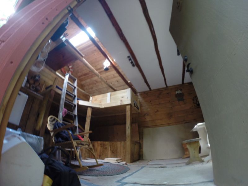

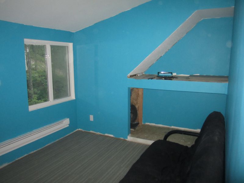

I am also a little late to the thread. I built my bunks into the gable end of my 2nd story. Although a little narrow made it half of the size of a queen (30 inches wide). I plan to buy a queen foam mattress and cut it in half to get the 2 bunk mattresses.

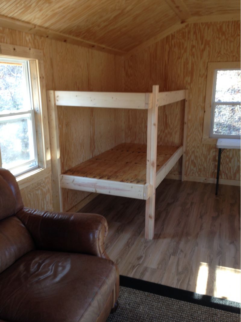

95% finished with my bunks. Still have to add a modest ladder to reach the top, add a side rail on the top for safety and add a small shelf and light for each bunk Basically framed everything with 2x4 and added 2x6's around the exposed perimeter to stiffen it up. Plywood for the deck with the intention to use air mattresses unless/until I decide foam is more comfortable. The deck is sized to accommodate a twin sized mattress. There is enough room under the bottom bunk to store standard sized storage tubs. Before anyone asks about the corner post being a few inches taller than the rest; I left it taller so I could level that end and then trim off the excess, but I forgot to trim it before packing up all my tools to come home.
Thank you everyone who posted. I borrowed a little bit from all of the posts on this thread.
Happy Thanksgiving.

Toyota, question on the 3 rack bunks. Question on the math or am I missing something. You say 3 bunks 28 inches of head room and bottom is 10 inches off the floor, Total of 96 inches, but doesn't take in the thickness of the mattress. I'm building similar 3 rack bunks, but each frame with 2x4 and 1/2 inch plywood I'm loosing 12 inches, then plus the mattress thickness.
# Posted: 19 Feb 2023 11:38am
You can route a 1/2in grove in the 2x4 for your plywood to slide into, then you would loose less space for the mattress. You could also screw the plywwod to the bottom of the 2x4 for a quicker easier alternative.
I have a top bunk you cant really sit it. It really dosnt matter though because I dont spend much time sitting in bed. The ones the really benefit from the sitting room are closer to the floor. I made my bottom bunk high enough for storage bins and 5gal buckets to fit under.

If you have 8 foot ceilings, first one set at 12" from the floor, you can fit 3 in with even space, but make a ladder for top bunk. Space under bottom bunk is great for storage and keeps you from sleeping on the floor feeling.
I used just plywood shelves, supported it just like you would framing a house carrying loads to the floor.
Mattresses are gel foam from a hospital and I zipped open the cover, narrowed the mattress up, zipped it closed again and fitted them in there. They are about 6'4" long.
Added rails to the side to keep from rolling out. Small tap type bunk lights ran by battery so you can climb into bed with light or read in your bunk if you wanted too.
