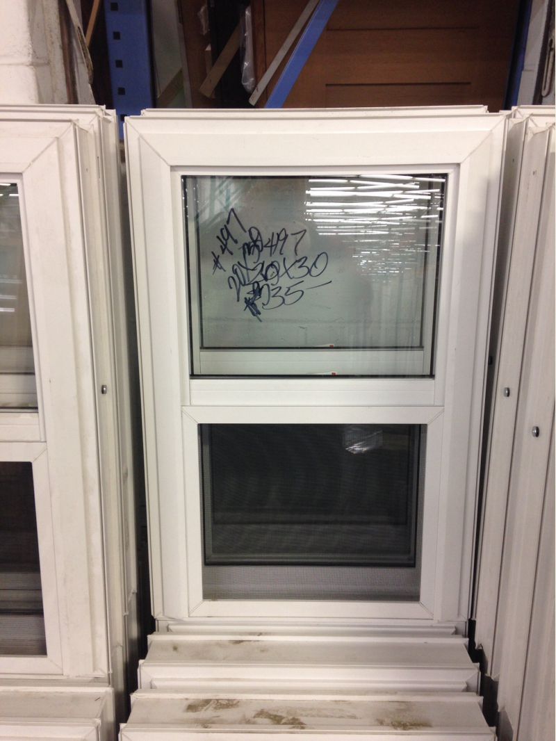

Has anyone here used replacement pocket windows instead of new construction windows? Putting together the plans for my cabin build and can get new replacement windows for $35 each. New construction windows are much, much more. Replacement windows don't have a flange. Other than that, not sure what other issues I would have using them.

These are what I am looking at. I would think I could level and shim and then nail them i through the sides right into the studs framing the window opening. Insulate, and caulk and then figure out how to waterproof from the outside with trim, etc. Bad idea?
# Posted: 29 Nov 2014 09:30am
Those are meant to fit into a frame that is already water sealed around the edges. So long as you work hard at sealing them it may work, but no guarantees. Ultimately your sealing will depend on caulk which will eventually crack and need to be redone. The nice thing about properly flashed windows with flanges is that they do not depend on a caulk seal. The flashing is overlapped with the fins to make a shingling effect that sheds any water away without requiring a caulk seal. Caulk is great until it cracks.

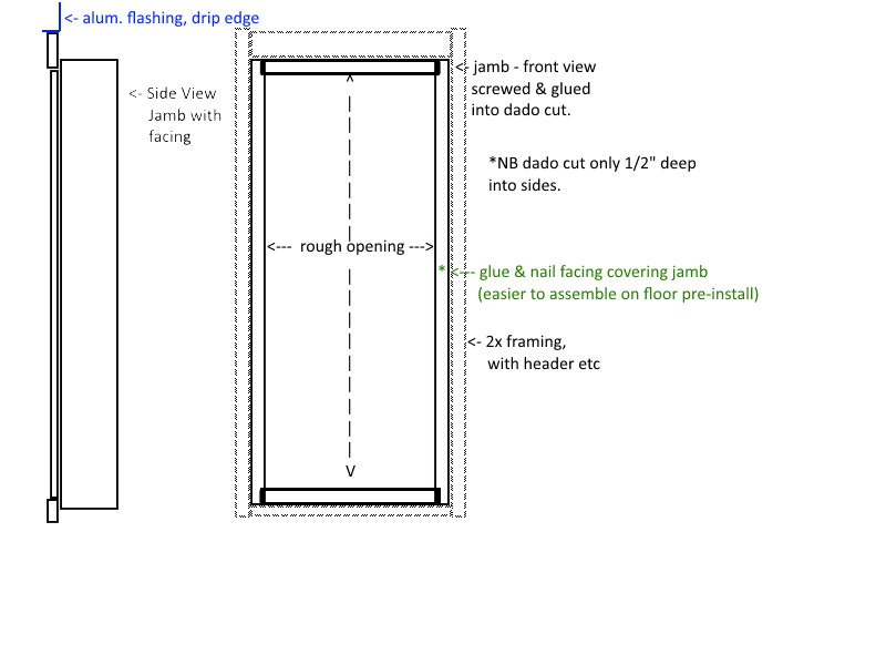

Bryan, don't use nails on the windows, screws only and be gentle.
These do not have any form of brick molding or flashing edges, so you'd have to figure something out to prevent wind, water penetration. There are a few options possible. They also appear to be for a 2x4 walls so if your building 2x6, you can use that to your advantage for a detail on the inside, by giving you a deeper window opening that you can trim out with wood or drywall...
As you are building from scratch now, you could make your openings to accommodate such windows by making your rough openings to fit (leaving a bit of space for shims & insulation, 1/2" would do it nicely).
I redid an old house built in the late 1800's and had to replace the original jambs. I used 1.5" thick pine to make the smooth jambs and 3/4" thick x 3-1/2" wide cedar on the outer edge face against the walls. Then used "insert" windows which fit into the jambs (similar to what your looking at). I put a 1/2" deep dado cut @ top & bottom of the jamb, glued & screwed it making sure it was perfectly square before putting it into the wall frame. Note that the jambs were tight fit to the original lumber of the house and I screwed them into place with a good healthy bead of Butyl Caulking under the "facing to exterior wall face" to ensure a seal.
I did it this way to match the original construction but used the PL-Premium Glue & Galvanised nails for the jamb. I also used Butyl Caulk between the facing outside to the wall (not visible to people) to make sure there was a positive long term seal between the wood. Cedar was chosen for the face for durability and to match the building. I did 11 Windows like this (I already had the Window Inserts as a previous reno had them installed already, so I recycled them when gutting the house). After the jambs were installed, I slipped the insert windows in and 3/4" from the outer edge, so they were almost flush to the outside, then put a 1/2" quarter round around the outside perimeter of the windows (with a thin bead of butyl to seal window frame and jamb). Lesson Learned: would have been easier to put the 1/4 round in before the windows, to provide a consistent & even window stop & not have the pain of trying to do it on a ladder 20' off the ground !
One thing I diverged from the original to new, was the original used an angled cedar edging at the top of the window facing boards as a water drip edge, I used aluminium flashing instead, sealed to the wall with Bluskin-WB.
In 10 years that I was in there afterwards... not a leak, air or water and no problems whatsoever. I may have over done it, or under done it, pending on who's opinion but I wanted things to look as they did originally and figuring that the original jambs lasted over 100 years that way, twas good enough.
Here's a couple of quick rough doodles to show how I did it... Should have noted in the images, the bottom piece of the jambs were cut to have a slight down slope for the last 3/4"... from the edge of where the window frame was going to be out, for drainage.
I did take photo's (pre digital) but they have been lost over the years... I know the people living in that house now and they haven't had any issues either.
PS: I used Butyl Caulking because it stays gooey & flexible forever but do not depend only on caulking, proper flashing and sealing is a must. If your putting Vinyl Siding or anything else, make sure you accommodate for that.
Window Facing
Window Facing
Window Jamb details
Window Jamb details
