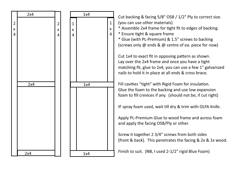

For my pump house, which has an odd door size, I had to make my own door... I needed it insulated so my method was different.
I used a 2x4 H frame and 1x4 H frame with 2-1/2" foam insulation in the door. I used 5/8" as the inner & outer skins but you can use other material if you desire. Everything is glued & screwed together and it's one really solid door and with a little gasket, pretty darn weather tight too.
In the past I made "utility" doors with 2x6 kiln dried SPF with a Z-Frame on the inside & black bolts going through. These were fine but when humidity struck things got a tad wonky. An old carpenter down the road laughed and told me I should have left a wee space between the 2x6's and instead route 1/4" tongue so as the boards shrank or expanded they would have movement and no "cracks" to see through... Twas a storage shed building so it was OK but lesson learned.
Below is a quick doodle of how I did it.
PS: I'm a huge fan of PL-Premium Construction adhesive and use it quite frequently where applicable.
Home Made insulated "H" door

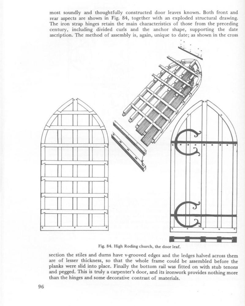

Don_P
# Posted: 1 Dec 2014 08:46pm
I've admired this design for some time. The vertical frame members are grooved to hold the boards slid in between them yet allow them to move. The horizontal frame supports, locks and flattens the door.
