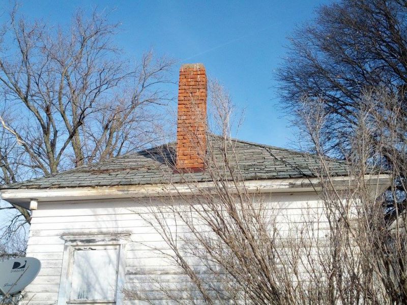

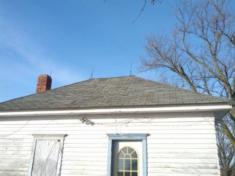

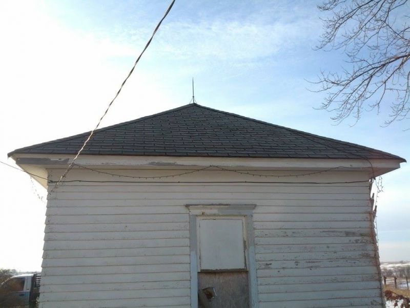

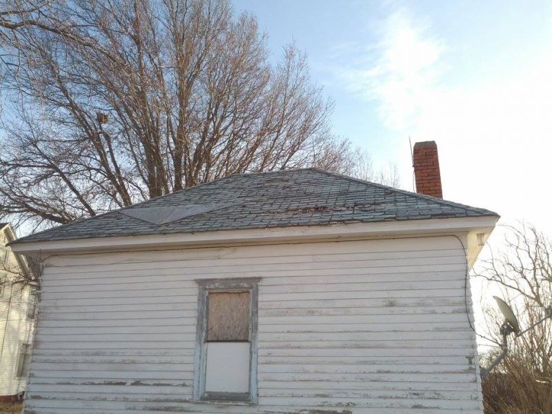

  i found some old pictures of the outside.  These are from when we first bought the house.  It has been repainted and had a complete new roof installed since these were taken.  I will take interior photos when i get home from work tonight.  sk1.jpg
# Posted: 11 Dec 2014 03:59pm
  Not much room from top of Window / Door frames to ceiling.
  Looks like clapboard but ain't... I'd recognize the corners a mile away...  Cement or Fibre board - possibly that nasty asbestos board...   hope not.
  I'd wager a guess...   Exterior Cladding onto 1xXX plank onto 2x4 with dead airspace to Lath & Plaster.  (note the plaster may have asbestos in it)
  SPECIAL NOTE !!!   Quite often in old places such as this, you will see some weird "board" sheeting behind where the stove / woodstove is/was... (sometimes also where the chimney is going through the floor / walls / roof ceiling)  Looks like a type of fiber board.. IT ISN'T !!!    95% of the time it is Asbestos Heat Panel / Shielding.  NASTY NASTY & NASTY !!!
  The fast way to know... use a water spray bottle (with a drop of dish soap in the water), wet it down on a corner, wearing rubber glove, pull a little piece off if it is tan or grey in colour and long fibres which are light & fluffy...  You need extra cautions & care removing that stuff.   Do wear a mask, you don't want to breath it in.
  I was exposed to this cr@p a few times - do yourself a favour & be smart, we know what this junk is, what it does to us and what to do about it now...  and how to safely handle it.  We didn't get it 20 & 30 years ago...
  And one last point.  You do not mention kids.. If you have'm keep them out of there till you are 100% certain it is safe for them....  Asbestosis is not something anyone should have to deal with.

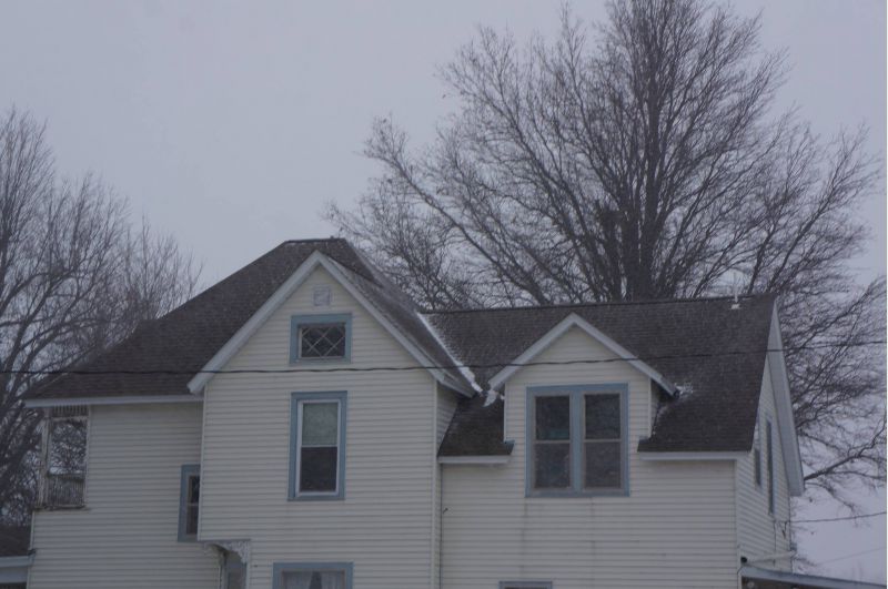

  as for space above windows you are correct there isn't much.  I will get the exact measurements tonight.  I really appreciate the advice so far. I have done lots of construction, but this renovation work is new to me.  I normally wouldn't do it, but i feel it is only right for me to bring life back to the house my great grand father built.  I am attaching the only photo i have with me of the big house and it is crappy, but gives an idea.
# Posted: 11 Dec 2014 05:27pm
  I think it's great to bring a good old place back to life.
  I wasn't trying to scare or anything, just warn of the unknown which can bite ya in the backside...  Old buildings with unknown history means god only knows what's under the paint and floors & in the walls.
  Redoing old places is a puzzle to say the least ! nothing square, nothing straight... Ohhh the memories .... LMAO  Your creativity "will" be tested...    which is a big part of the fun too....
