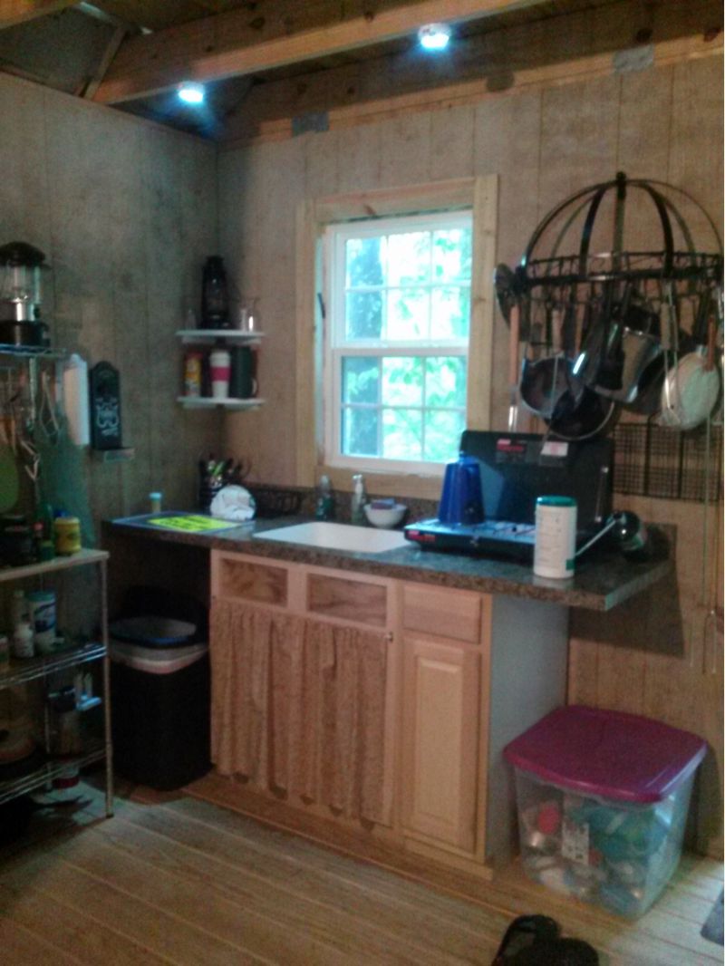

 We used 4x8 barn wood siding from Lowes for the interior. Runs about 14.00 a sheet and is heavy stuff. We are in super humid KY and warping was a concern in our off grid shabin.  This product has done great and I suppose it could be painted one day if we chose to do so.

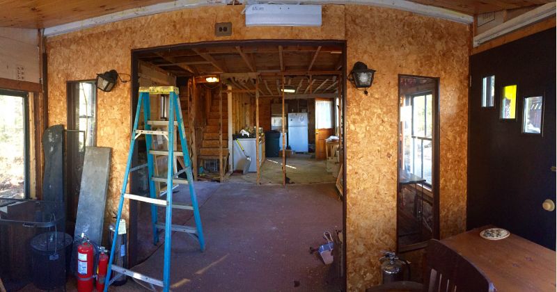

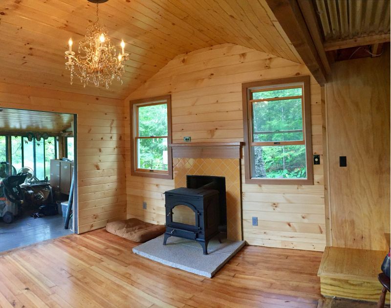

| Eddy G Member
 | # Posted: 12 Mar 2018 12:13pm Reply

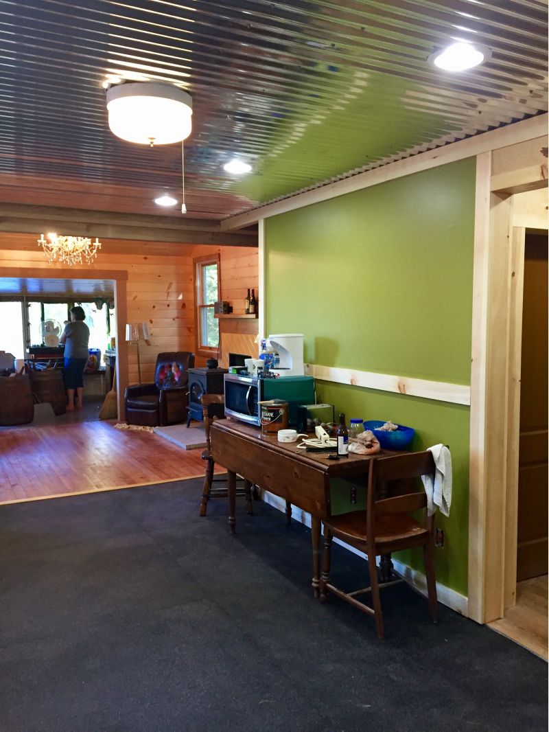

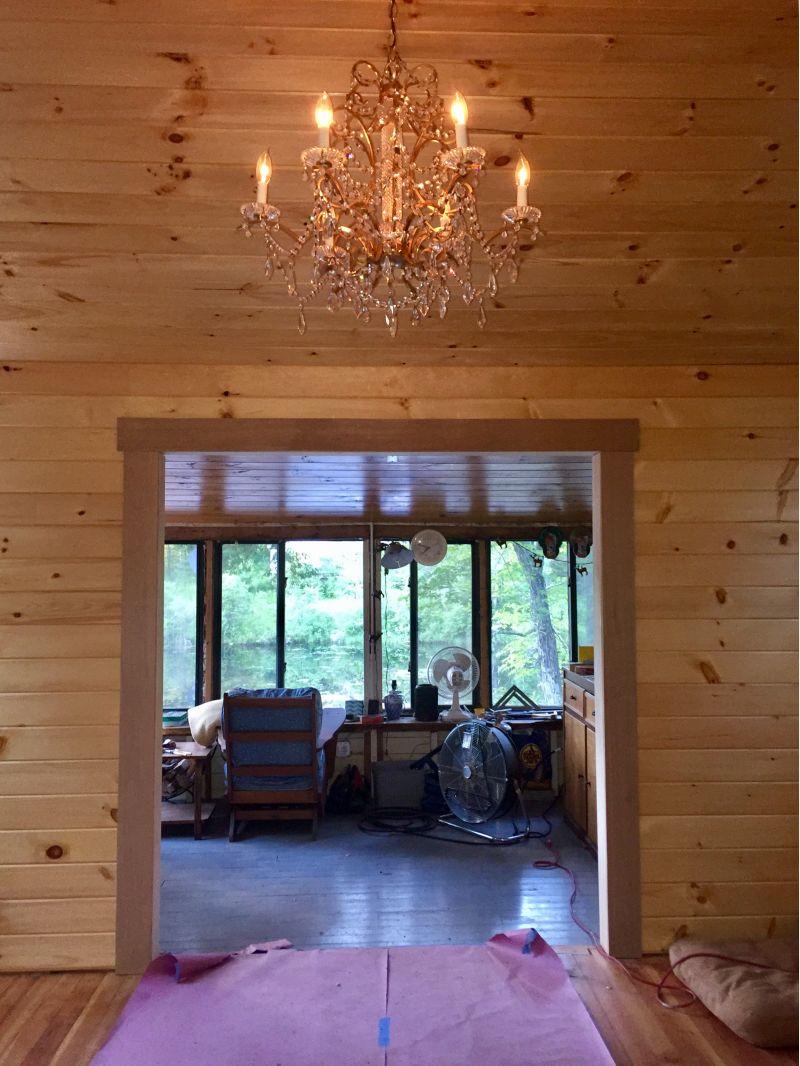

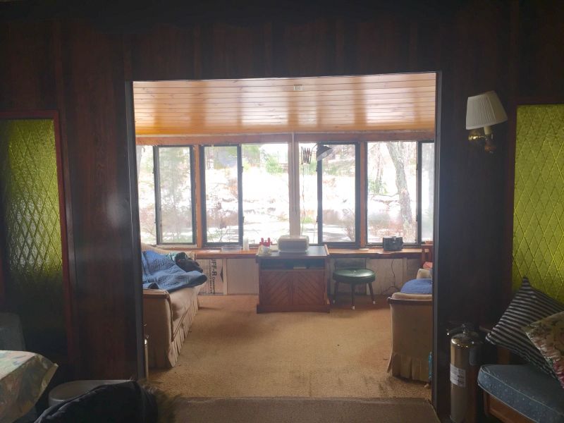

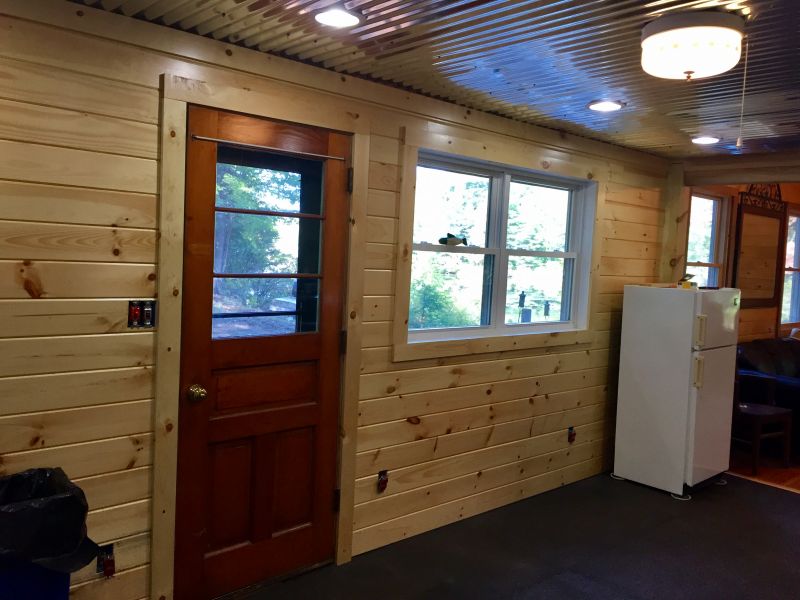

 I've done mostly t&g pine but incorporated some drywall and even some plywood on the walls...
 Use to be 1960's cheap and dark paneling and partial board either varnished or with a layer of joint compound spread on it ...it was pretty ugly...

| Eddy G Member
 | # Posted: 12 Mar 2018 12:20pm Reply
 Another before an after
