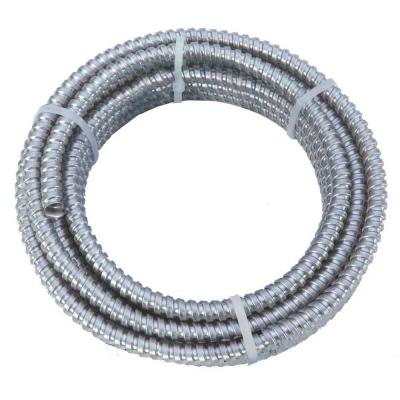

How about that flexible conduit. Use the correct terminating fittings also to tie it into the box too. Advantage is you could pull come extra wire through later also. And then you could pull just lose wire instead of the romex, ie colored wire from the spools.
http://www.homedepot.com/p/AFC-Cable-Systems-1-2-in-x-100-ft-Flexible-Aluminum-Condui t-5602-30-AFC/204847342?N=5yc1vZbohlZ1z0usgq
1/2" AL conduit
1/2" AL conduit

I would recommend the blue "smurf pipe" plastic tubing (Electrical Non-Metallic Tubing or ENT) over the aluminum tubing for this application. It's cheaper and easier to re-pull through later.
As an electrician I have re-wired a lot of old houses and I have yet to come across mouse-eaten wiring being a wide spread problem. Certainly you don't want mice, but regular romex should be sufficient. You might try filling the holes around any wiring with Great Stuff spray foam.
