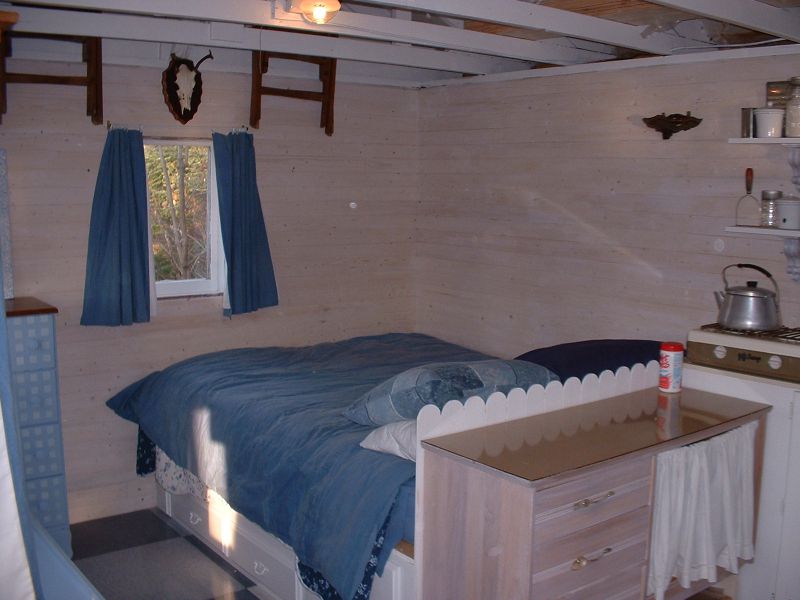

  our last place Mrs Fishie wanted to white wash it.  I was cringing as I love natural wood.  But white oil paint, mixed very thin with paint thinner and applied quickly with a rag turned out beautifully.  Not sure I have a pic on my computer, but I was sure I would hate it, and instead really liked it.  Just that bit of white really brighted up the place, but you could still see the wood.
# Posted: 8 Jan 2015 08:09am
  found one

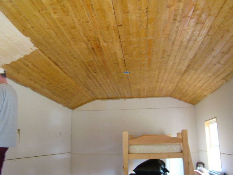

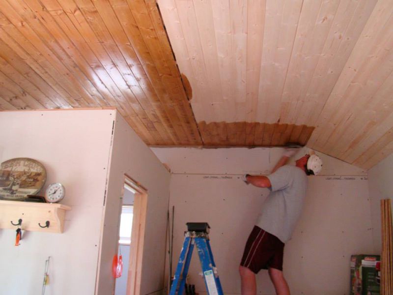

# Posted: 1 Aug 2015 10:47pm
  we used minwax stain and cabot polyurethane to finish.  A friends husband that is a painter recommended a lambswool, real wool applicator for the stain.  It really soaked up the stain and did not drip back on me.  For the poly I used the foam cigar type rollers not much mess there either, but nothing was finished under me either.  559976_566115214985_.jpg
