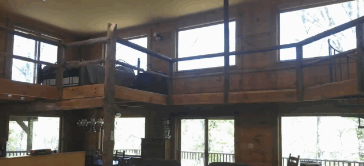

  I'm thinking about adding iron or black powder coated aluminum balusters (spindles) to the balcony railings at our cabin.
  The photo below shows that the middle and top railings are round, but the floor where the baluster would attach is flat, which presents a dilemma.
  I'm thinking the balusters would only be between the floor and the middle rail (not all the way up to the top rail).
  The balusters I've seen for sale are usually round on both ends, so that they can go into holes drilled into the rails....
  or flat on both ends, so that they can be attached to flat boards.
  Anyone ever seen balusters that are round on one end and flat on the other?
  Anybody else solved this design dilemma a different way?

  Could you make or buy small round bases for the bottom end?
   Something like the full round end on closet hang bar sockets.
   Kinda like this, though there may be something thats a closer fit to the end of the pieces you want to use.

  local welding shop... or, everyone needs a little wire feed welder
# Posted: 14 Jan 2015 09:45am
  +1 On Don_P suggestion.  You may find that a local metal shop / fabricator will be more cost effective.  Alternately, get a little Mig Welder and learn to use it...  You will be surprised at how handy you'll find having a Mig around when you have projects... and the new projects that it will let you get into.

  If you go with the round on both ends, you can simply add a 1x2 or so between the posts at the floor that has the holes drilled to accept the balusters.  Problem solved.  Quick, Easy, and Cheap.
