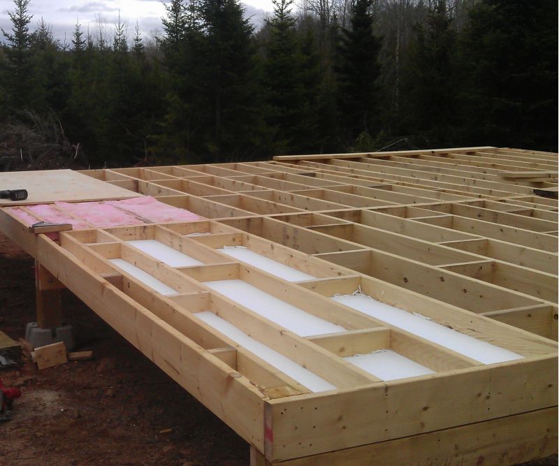

Helped a buddy fix his floor where he had infill insulation between joists. Like Huey he had an raised open floor. When we pulled up the old floor we found the insulation (pink) in pretty good shape. But they had put a vapour barrier under that stapled to the joists. The vapour barrier had trapped a lot of water. Basically he had a lake under his floor. The humidity had then ruined some of the subfloor.
The general construction quality of this building and the understanding of moisture was very poor tho... luckily we fixed it in time. And watch out where the vapour barrier is...
The solution I use is to put rigid insulation on top of the subfloor. Works a treat. Even if it is a pain to have to pull out the doors and raise them up (renovating). And then put down a new subfloor. Not doable in some situations I imagine.

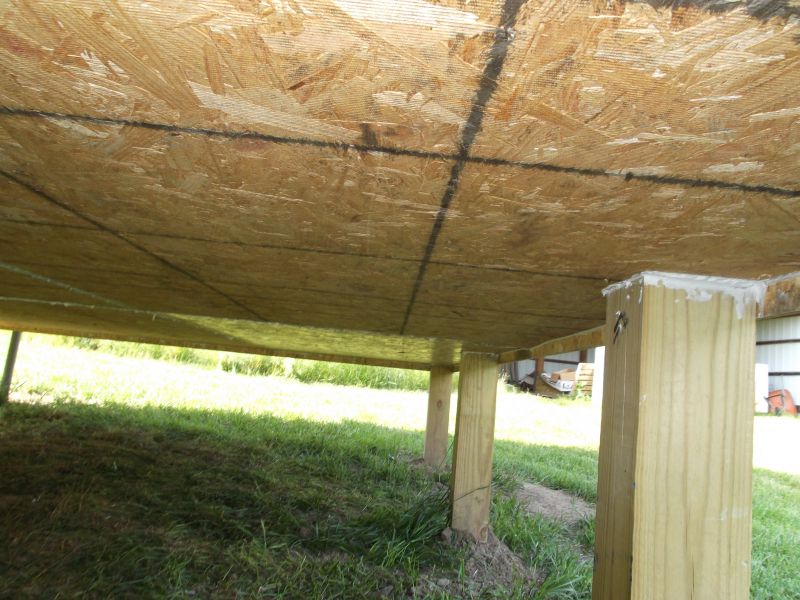

Mine is also about 3 feet off he ground. I used fiberglass insulation and then plywood to hold it in place and keep the mice out. I also caulked all the edges and seams. Been two years and it has worked well so far.

I would agree with MtnDon. More labor time to install insulation and sheathing, but certainly worth the time and effort. I used batt insulation, sealed the bottom with OSB and screw fasteners. Had my son to help with fitting and lifting of the sheets of OSB. Then used 1 X 2 pine around the perimeter. I never did apply any kind of a sealer or finish but seems to be holding up well.

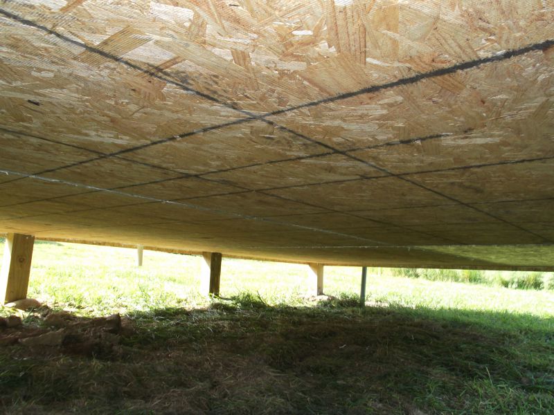

Our cabin is on piers and we insulated the floor. Using someone's idea from this forum we tacked 1/4 mesh galvanized hardware cloth on the underside of the joists and made sure there was overlap. Also used spray foam in areas that looked like they might not be overlapped enough. This has worked well for over 2 years now. NO MICE or any other varmints. The only thing I have noticed is a dead wasp or two on the underside that crawled through the mesh. We felt in super humid Kentucky this was our best option. The biggest problem was trying to find that size of galvanized hardware cloth. I finally ordered it off Amazon.
