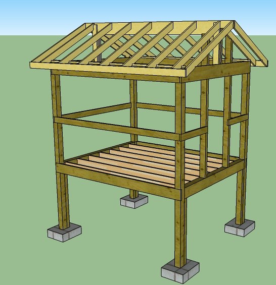

# Posted: 5 Feb 2015 02:01pm - Edited by: Don_P
Reply Quote
I've been doodling on a 10x12 postframed building. The posts are 6x6 treated. Across the 10' ends is the girder that carries the floor joists, under that girder are chunks of 4x6 treated down to the footings. That girder built up of #2 SPF or better could be 3 2x8's sandwiched together. Or if you have good maple or better a sawn 6x10 girder. Screw into the end of the girder through the notch for the floor rim with some ledgerlocks or similar. The joists run the 12' direction and could be as small as 2x8's in stamped lumber, in home sawn lumber go with 2x10's. The gable end top beam supports a ridgepost that supports the 2x12 ridgebeam, 2x12. The side 2x12's support the ends of the rafters, notch them in on each side. At midwall there is a let in 2x girt to support board and batten siding. Under the boards there should be X's of metal strapping wherever you can work them in between openings. Tin on the roof and it is an uninsulated low cost structure. Wrapping it in a layer of T-111, ply or osb sheathing eliminates the need for the steel strapping, the sheetgoods brace the structure better than strapping and would help airseal it. It could be wrapped in sheets of foam to make it a tight 4 season structure, at quite a cost. Anyway, just more to ruminate.

Wow good information over here thank you. I was about to do a sketchup. I was more thinking of a Shed type roof, for the lower use of materials.
Which kind of tree can I use for the 6x6 posts? white cedar?
Don_P
# Posted: 5 Feb 2015 05:17pm
Reply Quote
White cedar would be good. For a shed roof you'll probably need a triple 2x12 beam on the top of each 12' wall to carry the rafters. For that matter it could also be at floor level with a load bearing wall on each of those sides.
