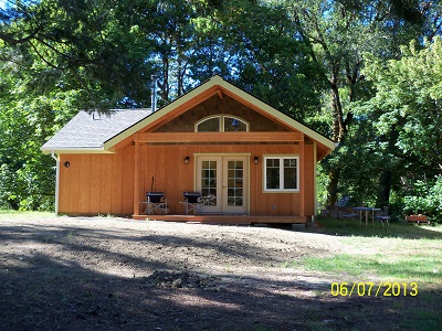

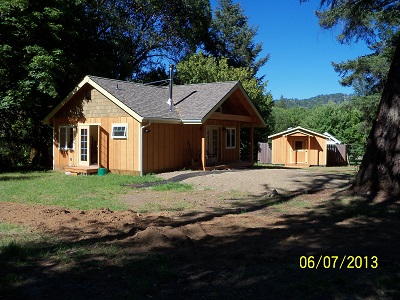

  BadgersHollow, They're in Central Point, near Highway 140. They go by miles and provide 35 miles each way free. After 35 miles, it says they charge a "minimal mileage charge." I don't know how many miles away from there I am but my land is right off 140 near Dairy.
  I'm sure they would charge me for construction since I'd be doing a custom project, wider than standard. But they would still have the materials cut and ready to build. The foundation would already be in, inspected, and ready to build on. Perhaps the pipes, too, depending on which way I go with the foundation.
  At the Klamath County website, it says if you call the office and leave a message for the inspectors before 7 a.m., they can send an inspector out the same day. That's actually pretty cool. One of the reviews said this company built their 12X16X8 building in 7 hours because they were totally prepared and professional. So, if I'm on top of my game with everything, and the inspection thing goes as the county says, the shell, plumbing/bathroom, insulation, wood stove, and basic electrical could be done in maybe three or four days?
  I can work on the interior -- the fun part, from my point of view -- at my leisure.
  Here's a house they did, from their projects gallery. Far more than I need but I was impressed.  635420Chalmet20Pre.jpg
