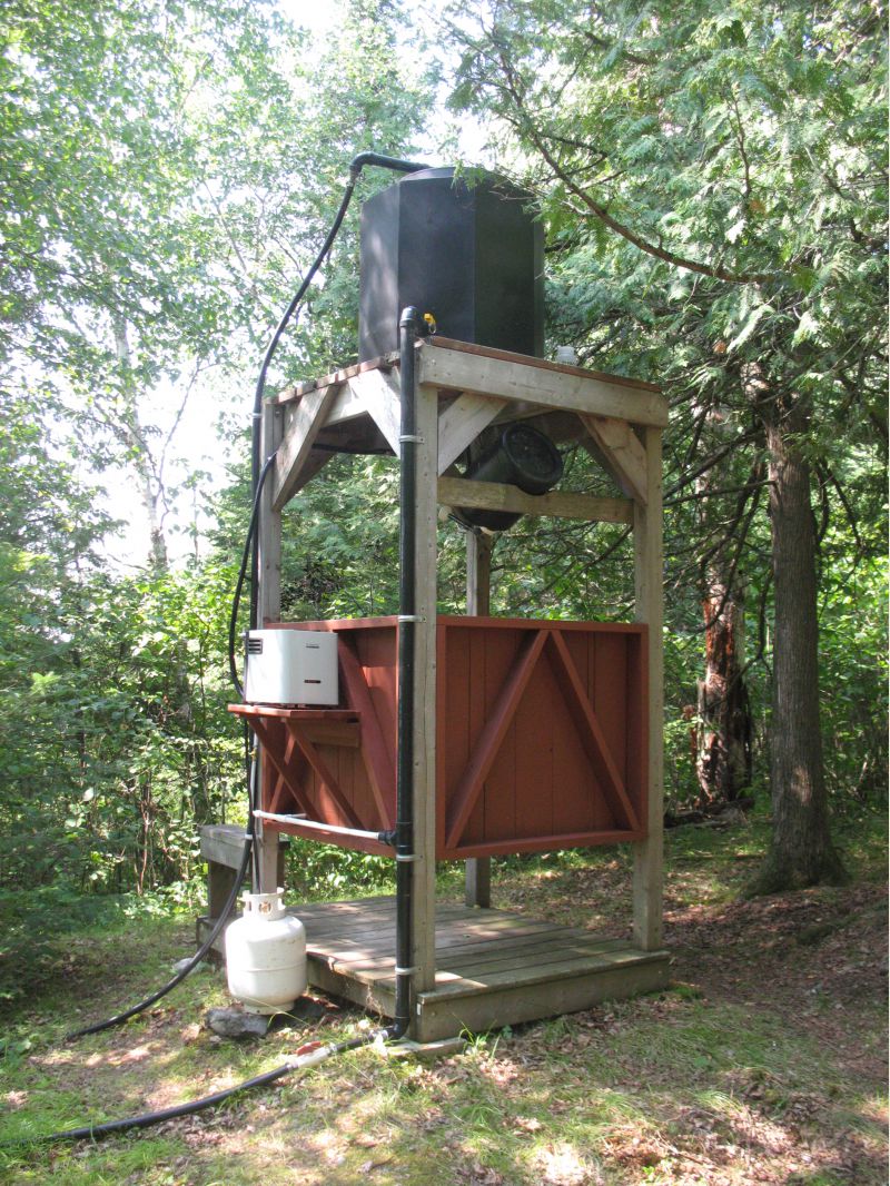

# Posted: 17 Feb 2015 12:37pm
Thanks again Mark. I have attached a picture of the outdoor shower. The black jug is how we used to do it. The perfect recipe is to heat 10L on the stove to just about boil, pour in the jug, carry up the hill, add 10L from a tap to the overhead tank, screw on the shower head, sling it up into the cradle. This water mix gives a perfect shower temperature of 43 C (109 F). With a flow rate of 2 L/min you get about 10 minutes so my wife and I can usually have a shower on one batch of water. About 4 years ago I added the Trailwood heater. I'm on my second one. I'm using raw lake water without a pre-filter which may be contributing to the short life of them. Anyway, the new system should be another step forward but I really do like the outdoor shower.
