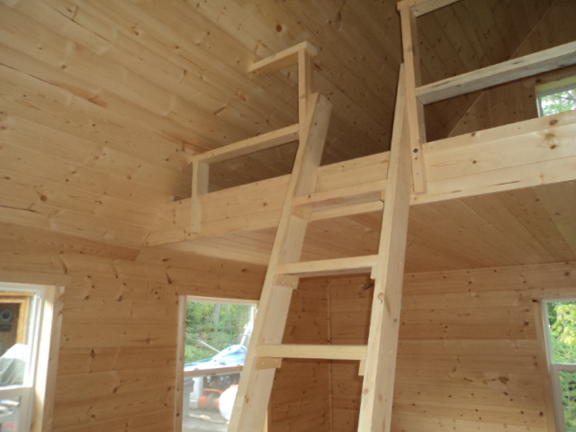

# Posted: 12 Feb 2015 10:11am - Edited by: OwenChristensen
Don has the best way, but it takes a lot of extra time. Most of my builds are spans 16' or less, so no joints are an option. Sometimes, on longer spans, I will have a cover strip to allow all the joints to be together, say at the edge of a loft. I think I might have a picture of simple staggered butt joints. I'll post it if I can find.
Note; if the wood going up is dry enough, your joints should stay tight. Tight staggered joints are hard to see.

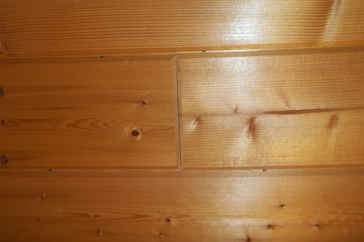

Don, do you have any pictures of your method? I'm having a hard time picturing it in my head.

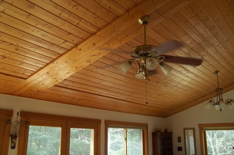

# Posted: 13 Feb 2015 12:26pm - Edited by: Don_P
Quoting: Dillio187
These are my ceilings. The first is a 36' long room, I didn't want butt joints and wanted to break up the long runs somehow so did a "picture frame". The second shot is upstairs, this was installed at ~12% where the greatroom was at about 8%, so the joints are more open in the second shot, there is the approximate difference in taking the time to really acclimate the wood to the driest in service conditions. The nails shot right into the edge of the tongues became readily visible and pull your eye to them. The way I route the end joint is what I'm really trying to show. These are both SPF T&G with Waterlox satin, a high VOC wiping finish.
The reason you see an erratic nail pattern, the T&G is applied to a layer of osb that is screwed through 2 layers of foam to the underside of the rafters, there is fiberglass in the rafter bays. One of the weaknesses of T&G is a whole lot of air moves through it. This not only sealed it well it gives good nailing anywhere. The T&G can be applied in any number of patterns or you could get really fancy and do intarsia .

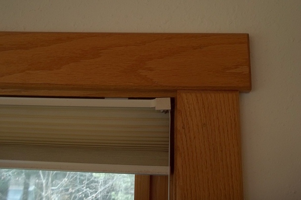

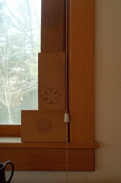

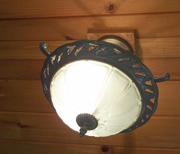

The last 2 shots above are of window trim done with the same router bit, a 45 degree chamfer with a bearing on the bottom. The oaks came from the property. There are some chip carved rosettes in the corner of the last pic. If you look at old house trim it often had rosette corner blocks. If you have evenings to fill they could be carved. The pic with this post is the ceiling fixture on our bedroom ceiling, eastern white pine with Watco danish oil, a flatter finish, still fairly high VOC. The mounting block for the light has a little chip carving on it.

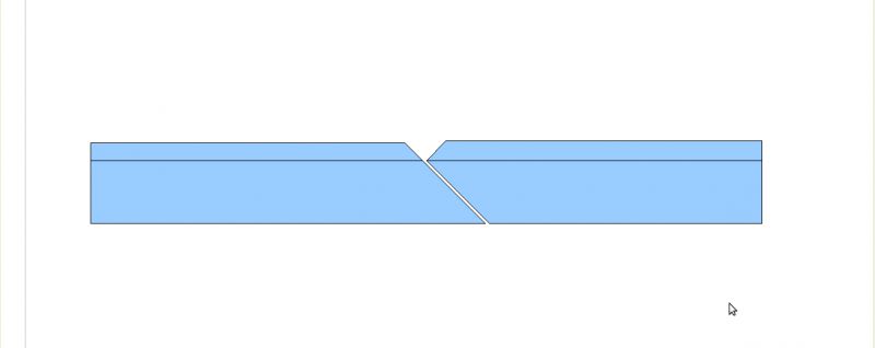

If you do all the end cuts at 45 degrees it makes those shrinkage gaps nearly invisible, and then no saw changes are needed to cut the chamfers although you do have to eyeball them very carefully. The board thats going to be at the back of the joint just gets a 45 cut. The one at the front gets a 45 plus a chamfer.
# Posted: 15 Feb 2015 09:12am
Don will have to respond to know for sure, but I think he means to just continue the V of the side of the board to the end. Not 45 deg. of the whole board thickness.

# Posted: 15 Feb 2015 05:05pm
Yeah, I think so too, but then if a gap opens up it's much more visible. I attached a drawing to show what I mean about the cuts.
# Posted: 15 Feb 2015 05:21pm
Boards shrink much less in the longitudinal direction, even from green state to dry. If you are staring out with wood that is even close to dry you should not notice any end gap shrinkage. Across the grain shrinkage is much more pronounced.

# Posted: 15 Feb 2015 05:48pm
No doubt boards shrink by a much smaller percentage in the long direction, but gaps can also result from slight inaccuracies in the cut (saw fence out of square, etc.) or settling of the house as the framing lumber dries and shrinks or the foundation settles. You can see that there is a tiny gap in Don P's second photo above. It might not be noticeable up in the ceiling, but I wouldn't want to see it in the wall at eye-level.

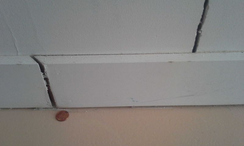

Remember that Don has osb behind his ceiling. You might less pleased with a line of pink insulation showing in a prominent location. The older house I'm in now has several significant drywall cracks and gaps in the baseboard caused by settling. Fortunately the worst one, at 1/4" wide, is in the laundry room.
Don_P
# Posted: 16 Feb 2015 12:42am
I like the chamfered scarf idea and it would be possible with a chop saw. My neighbor would just cut a 45 scarf without the chamfer on T&G.
