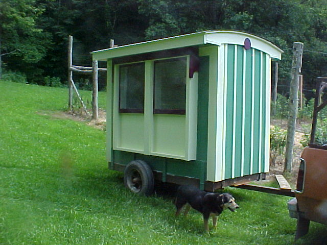

  I'd bet you could get old axles and wheels for a song, welded up to become rigid foundation elements with the track and a gravel bed might be another way to go. A track on a gravel base is rated for more load than you'll ever see.
  I built a gypsy wagon style chicken coop for our place with a curved roof and just slapped roll roofing on it. I think it's 3 years later and I need to rebuild it. Good drip edges around the entire perimeter and get what overhang you can. I think Fabral or one of the metal manufaturers has max curve charts for their panels online. Site formed rolled seam flat panels with butyl in the seam and rolled to lock over the eave drip edges would probably work well.
