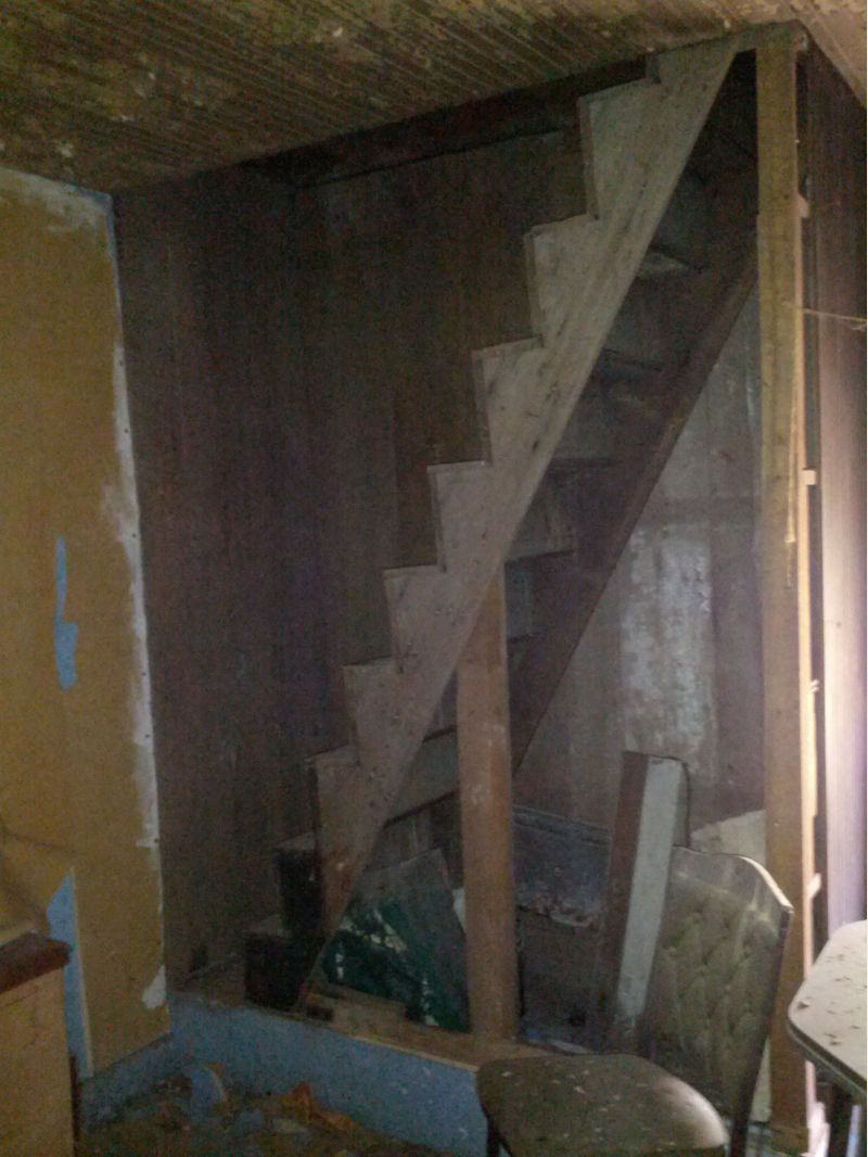

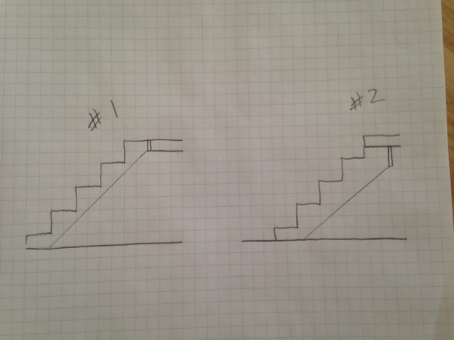

  I'm trying to calculate the stringers for my stairs. But I really need them to tie into the floor joists as in the picture #1. Most calculators want to tie them into something below the joists as in #2. I've also played around with on line calculators with the same figures only to have different angles in the results. I'd like to get this right the first time   Anyone have experience with this? Thanks! These are the stairs I'm trying to replace. They didn't come out in one piece and so I didn't get any measurements. The top run was incorporated into and a part of the upstairs flooring. Trying to keep the cabin original.  IMG_0220.JPG

  Are you over thinking this? Just deduct the one tread and the thickness of the floor for riser.
Smawgunner
# Posted: 19 Feb 2015 11:05am - Edited by: Smawgunner
  It changes the length of the total run which has an effect on the other figures and angles. I've never done this before so maybe I making it over complicated but the calculators I see online are very very complicated to me anyway.

  You are trying to replicate that? Maybe the picture is turned on its' side.
  Count the number of risers on the existing stringer. Measure the overall rise from finish floor to finish floor, divide by the number of risers, it should be on or very close to what you can measure on the existing stairs. For run just copy the average of the existing unless there is some reason not to. Then using a framing square transfer the rise and run to a straight piece of stringer stock. I'll often nail stringers together and let the saw begin to mark layout on the next one.
# Posted: 19 Feb 2015 12:15pm
  Take your total height you have and divide by 7.5. This will give you the aprox. number of risers. Now round that off to a whole number and divide the height again using that whole number. Now you have the exact riser height needed. The run will be determined by the thread times the whole number that you used. Then like Don said use a framing square with the rise and run marked out to see what you need to cut out. Remember to allow for the thread thickness on the first and the last step.  PS. most stairs feel good with a 7 to 7.75 rise and a 11 to 12 inch thread.

  It looks like LOTS of rise and not much run (tread)

  LOL, thanks all. The picture is not on it's side,..there IS lots of rise and little run! That's the way those old cabins were built back then. The stairs were totally destroyed so I can't take any measurements from them.

  I don't think there's room to get into anything near normal. Hanging them as in your #2 sketch would make them a little less steep. Have you considered an alternating tread/ ships ladder/ Jefferson stair type of stair?
# Posted: 19 Feb 2015 10:02pm
  In the photo there are 10 runs and 10 rises . The rises must be close to 10.5 in. as the ceiling height is likely 106 in .  the runs look to be 6 or 7 in. measure the distance from  the support post to the mark on the floor were the step ended  and divide by 10 to get the exact number . that should give you all the numbers you need to reproduce the steps .imo
