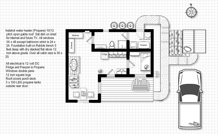

  Scrapped old plans think I've come up with better design and its even to scale let me know what you think and what you would change. Using common plumbing wall so PEX tubing doesn't freeze. And have second EXIT in case something might happen. Also now have More counter space and dedicated utility room where I can store my batteries and other things I don't want to freeze. The wind blows from the east and north so I don't really want windows on those sides but may add a east window for those hot summer months. Stove pipe will come up wall and travel along ceiling to exit out of bedroom ceiling allowing more heat to be retained. Not sure on code for this but will check. Total sq ft of cabin is 654 sq ft. Now thats tiny house living in style. Plus I have storage above the ceiling I haven't even figured out how to use yet, but probably just gonna insulate the crap out of. So let me know what you would change and why. Please don't just say change this I want the reason behind it.

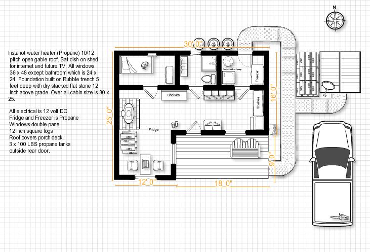

# Posted: 28 Feb 2015 07:18pm - Edited by: felineman
  New layout but same size I think this works better.
