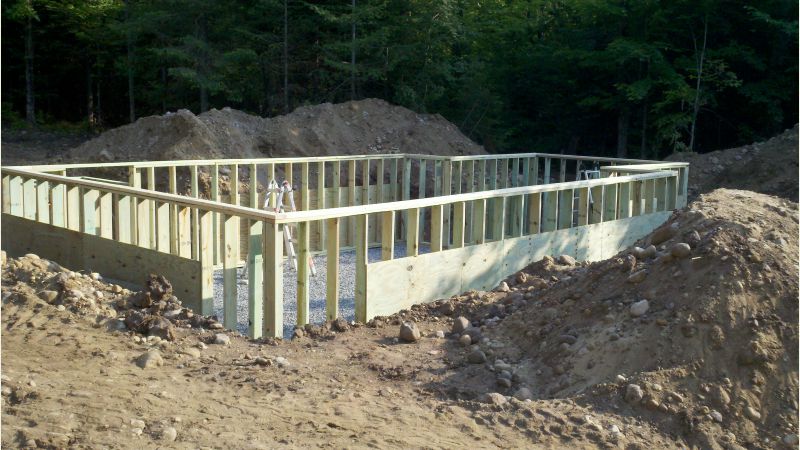

We used a pwf foundation on our camp project and it worked out well.
# Posted: 9 Mar 2015 11:21pm
I have a wood basement on my primary home and has been in the ground for 33 years. I built my home from ground up and did all the work. I saved a lot of money! LOL
Mine is a 4 foot crawl space with about 5 foot from ground to joists. Treated plywood 2x8 treated lumber was used. Then 3 coats of tar and then a heavy plastic was added.
Mine is insulated between the 2x8 studs. The wood on the inside is just like I put it in. The outside I have dug up many times in places and looks great. In my area there is a lot of wood basements and I have not heard of any problems. At the time is was very cost efficient compared to cement.
I have been very pleased with mine and no issues.
