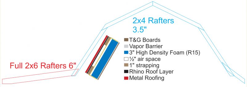

So, building my cabin using reclaimed material, namely the rafters. They are 2x4. I am insulating only to R15 by placing 3" foam between the rafters. I added a small leanto to the building and used full dimension 2x6 for that rafter.
I've attached a pic showing the roof and the layers from T&G, Vapor Barrier, Foam, Strapping, Rhino Roof stuff, Metal roofing. (Also Soffit and Ridge vent is in place).
As I was building all the local builder guys said my plan would be fine in my small 14x20 cabin, (main part is 14x20, leanto is 6x20 - cathedral ceiling 16' to top) that I'd have no problem with the lower r value and keeping the place warm - maybe just add another log to the fire - fair enough.
Today I mentioned what I was doing to another local contractor and he was very concerned that with only r15 the warm air hitting the cold will lead to tons of condensation, ice buildup on the roof, all kinds of nasty problems with water...
As a result of that conversation I'm VERY, VERY stressed out over my roof - and it's built already, just putting in the 3" foam this week. I could build up the rafter and add 3" of roxul inside before adding the vapor barrier. I'd loose that much head room in the loft but I can only stand up dead center as it is.
I'm rambling, sorry. Any and all opinions are really appreciated. Thank you very much in advance.

You would be better using an A/B spray foam not only doe it stop condensation but provides a vapor barrier too. And is alot more then R15. If you want it to last build it right.

You could have some issues. How much will it be used in winter? If it is not used in cold weather there won't be a hot - cold differential to cause problems. The more it is used the greater the likelihood of problems.
Use XPS foam to fill in the rafter bays and seal them well using foam in a can. Do not bother building up the rafters. Do not bother with the air space, push the XPS foam against the roof sheathing and seal with the foam in a can. The idea being to seal that cold roof underside so air and moisture can not condense there. The sealing has to be done well enough to stop air movement. You do not need the exterior roof vents if the space between the rafters is fully filled with foam. and you do the next step as well.
Or skip all that messing around and fill the bays with spray in foam. Closed cell foam will get you close to R7 per inch. Open cell will be less than XPS at about R4.
Then install sheets of XPS foam against the inside surface of the rafters. That also provides a thermal break at the rafters and makes the insulation more effective. There are 1.75" diameter nylon washers made for this purpose; used with screws long enough to anchor in the rafters. OR use 1x furring strips and screws through to the rafters to hold the XPS in place. Do that and you don't need the vapor barrier sheets; the XPS is a barrier when installed tightly. Best results in 2 layers with the panel seams staggered.

We will be fulltime in this. Weekends for the next 2 years then fulltime. At that time the cookstove will be fired 24/7 pretty much from late october until may.
Even if I push the foam as tight as i can I'm only against the strapping and rhino roof wrap, not tight against metal. Foam on leanto is in and sprayfoam sealed...3" gap above that. Argh.
I have 3" roofmate foam board. If I add 2 1" layers I'd achieve R28-29.
That with the airgap? Thoughts?
What about adding boards over the additional 2" of foam?
Yes, just a sleeping loft. Its a no-jumping-jack zone.

# Posted: 28 Feb 2015 09:33am - Edited by: creeky
The problem you'll have with putting the xps up against the roof now is that any moisture that gets in there between the vapour barrier and your xps insulation has nowhere to go. This could be a problem for your strapping and your rafters.
So I would leave the 1/2" gap as you have it. Make sure this can vent somewhere (I suspect you've thought of this already, watching for insect infiltration etc).
Then I would put up my xps between the rafters as you have it. I would spray foam to seal the edges. Being aware that you now have a second vapour barrier.
This brings your insulation flush to the outside edge of your rafters. Now you could add another layer. Maybe poly iso? Right across the rafters. Even one inch would bring your well sealed r15 up to r22 (give or take). Two inches and you're at r28.
Now you have a breathing area for your rhino/strapping/rafters. And you have a high insulation roof/ceiling complete with vapour barrier. You're all set.
It'll work great. Congrats. Nothing wrong with this design.
And you'll need some longer nails/screws for your interior finish layer.
(Ideally the insulation goes on the outside of the roof on top of the vapour/rhino barrier.)

Check. Yes, I have tons of ventilation in the soffit and ridge vent.
I should add that the rhino roof layer is only tuck taped on one side, forgot the other. Not sure how much that matters. Its well overlapped. Saw it more as a failsafe if the old tin roof leaked than anythong else.
Quoting: creeky
Yup, got 12 cans of foam.
*So you're saying that the rafter foam/spray foam is itself a vapor barrier? Then no need to add a layer of plastic, black glue edges, over this? (like I will be doing on the walls)
Looking into locally available options....searching homedepot.ca (if you know of a suitable product feel free to link - thank you.)
So...R22+ will be ok? That's a real load off. Bigtime.
