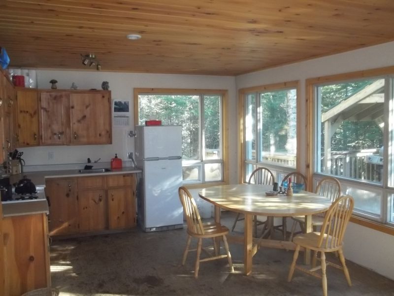

  Did my camp with tongue & groove pine - very happy with it.  ALso notice a screw up with the fridge - didn;t realize that most propane fridge need to be on an exterior wall for venting!

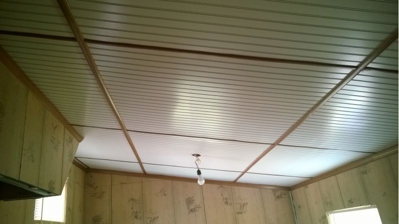

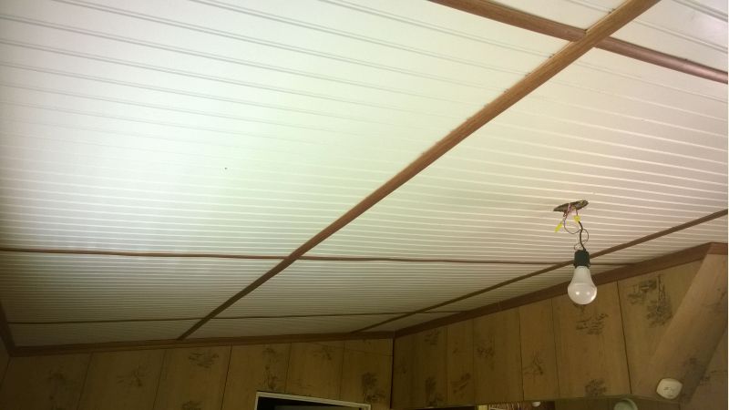

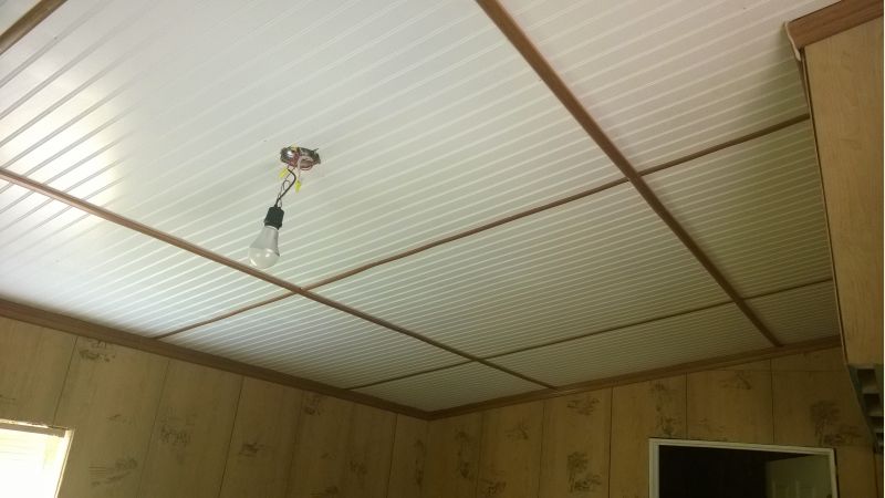

  We ended up deciding on using some white paneling for the ceiling. We've cut them up into 4x4' squares and we're going to cover the seams with some dark wood trim (yet to be determined.) Got about 2/3 of the paneling up and my broken elbow decided I had done enough so I'll finish it up next weekend. Maybe between now and then we'll decide on some trim.

  white will really brighten things up if you have a dark cabin.  Our new to us place was plywood with strapping over the seams.  Place was dark.  We gutted it, so took the opportunity to take in the paint sprayer and spray the entire ceiling white (actually Mrs fishie did the painting while I was in the attic running 12v wiring.) The difference when I walked into it with white ceiling was amazing.  Even at night now a few lights keep it very bright.

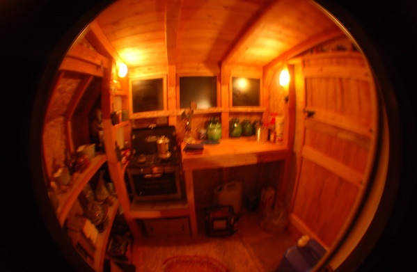

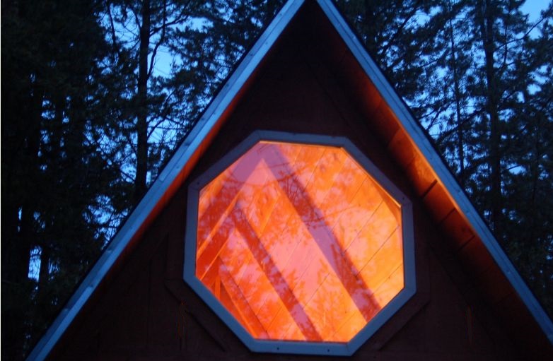

  Our cabin is rather simple. 2x6 roof Thus, exposed 2x6s for the ceiling  kitchen

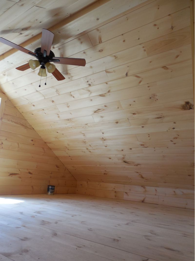

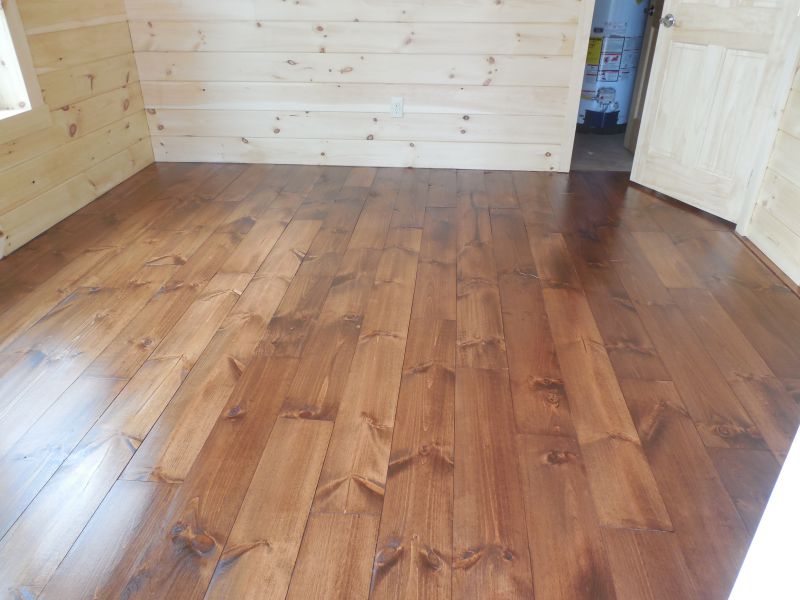

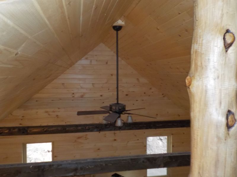

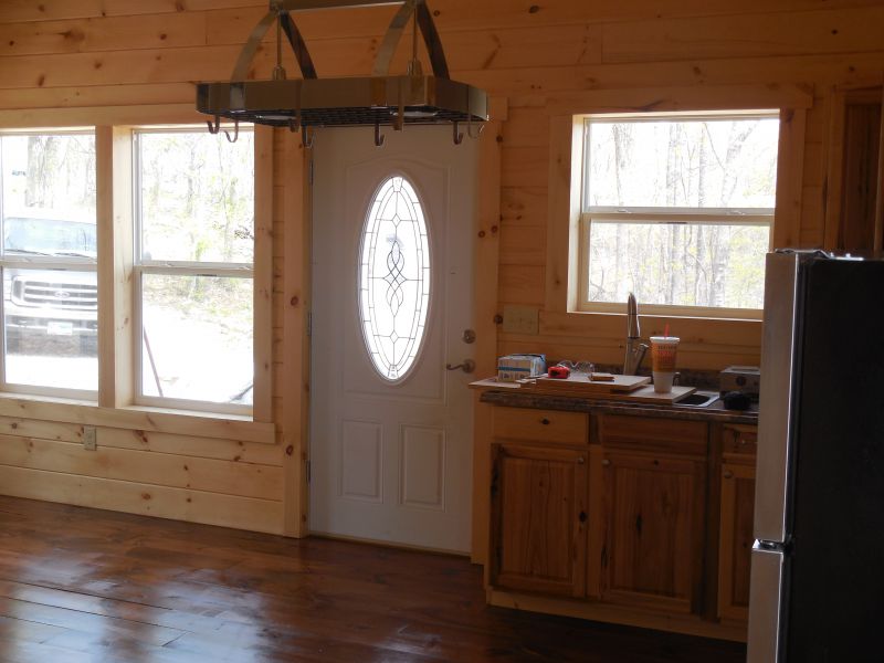

  We did our ceilings and actually the entire interior of the place with 6 inch wide pine car siding.

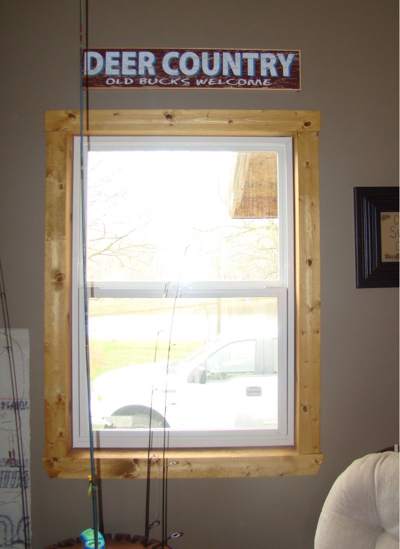

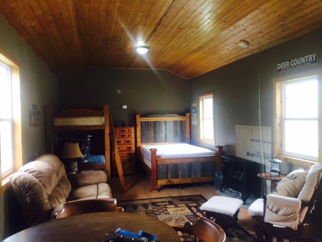

  In the end we chose the t&G pine for the ceiling.  I had wanted it originally for the warm look, but on a budget build my second choice was to get the stucco/textured look wall paneling from menards (DPI Earth Stones 4' x 8' Paintable Hacienda Stucco Hardboard Wall Panel)  I was going to use latex caulk on the seams, stipple it and knock it down to match the texture of the panels to hide the seams. Hope that makes sense.  The main reasons were simplicity to complete the job and not having to sand drywall overhead.  I also considered building faux beams to cover the seams but it would have really added cost.  Not sure if you have a menards close by but they run a great sale on their thin t&g pine buy one get one pack free a couple of times a year.  It really made the choice easy then.  I was a little concerned about the thickness but it really installs nice, we have had it up for two years now.  I even bought more and ripped the tongue off for baseboard and made a narrower rip for casing.  Super cheap, trimmed the whole cabin for $30.  Good luck  t&g ceiling

  Well, this is what we decided to do in the bedroom for the ceiling. I bought 4x8 sheets of white paneling and cut them into 4x4 sections and then put up trim to cover the seams. My wife is very pleased, which is the most important part in my book.

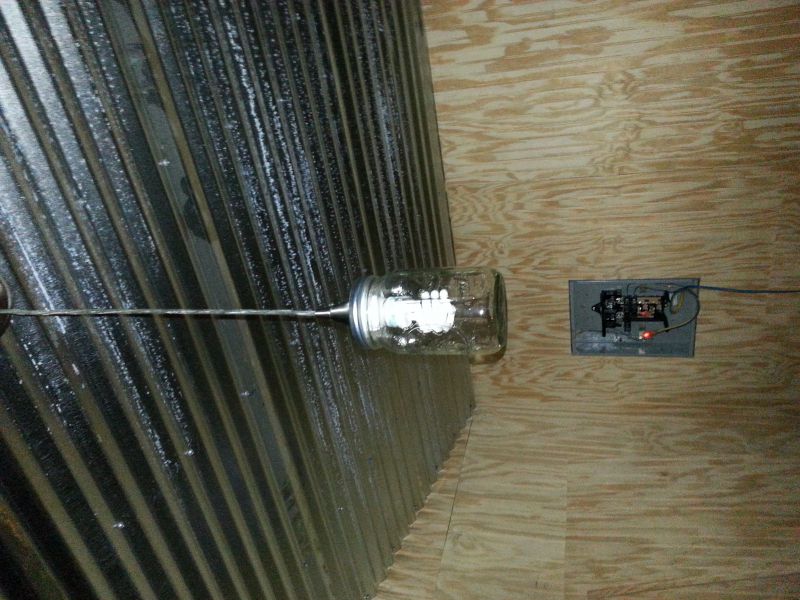

  I did a T&G Knotty pine on the outer 2 feet and corrugated tin on the inside space,, looked so good I did it in the bedroom too.

  MJW, I like what you have done.  I have a similar bunkhouse that is unfinished inside.  Where did you source your interior wood from?  And, how did you vent the roof?

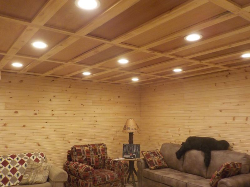

  We went with 8 inch wide T & G pine with a v-notch for the upstairs and downstairs used 1/4 inch panels like a drop ceiling. Panels can be taken out and put back in very easily.
