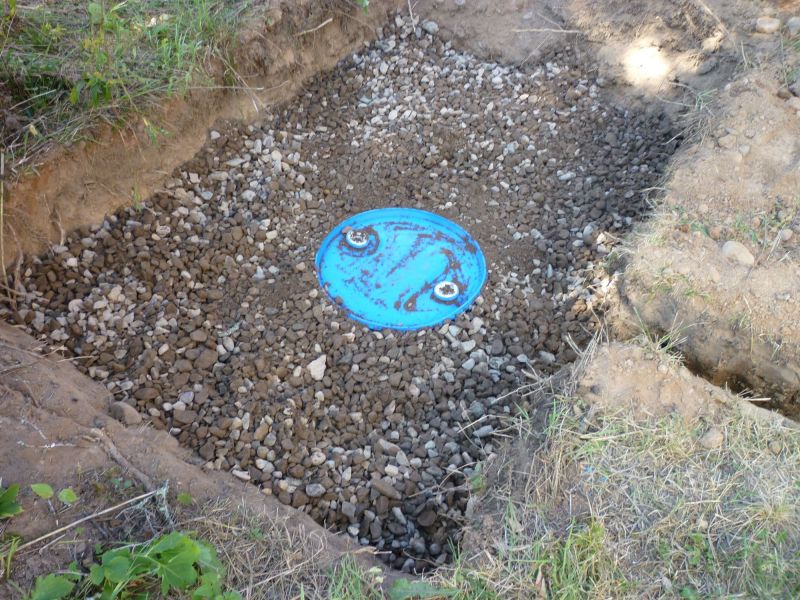

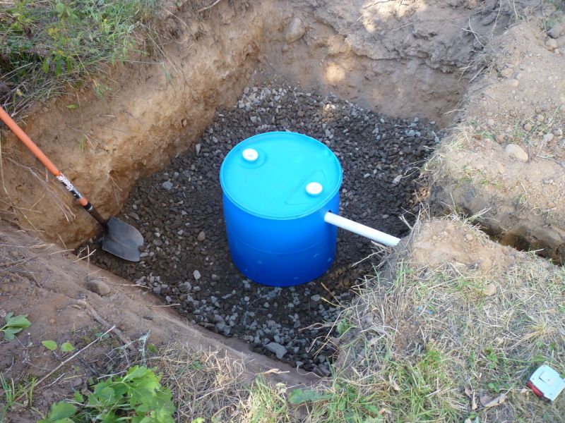

Mine is fairly simple in design, but it helps that my neighbor has an excavator and a gravel pit nearby. It's a 5'x6'x4' deep pit with a cut-off 55 gal drum with rock underneath and around it. Landscape fabric was laid on top of the drum and rock, and backfilled with dirt. The hardest part was digging the trench from the cabin to the drywell.
