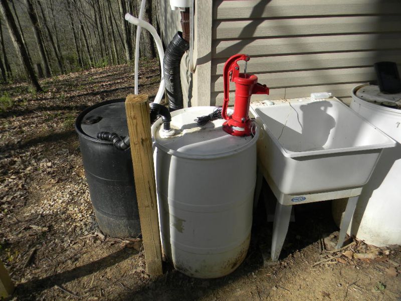

# Posted: 23 Mar 2015 12:04pm - Edited by: SE Ohio
I too favor the concrete approach.
If you have cabin gutters, one can divert rainwater into a 55 gallon barrel easily enough. Another low effort way to gather a bunch of rainwater would be to string a tarp into a "V" shape between trees, etc. draining into such a barrel. 55 gallons would be enough to mix up a fair amount of concrete.
Columbus OH Pepsi bottler sells emtpy 55's for $5 each. You'll never regret having water on hand. You can gravity drain, siphon or pump water from barrels.
Of course a good-thick rock of substantial area planted below frost line would work well as a post footer, but at cost of extra digging. Freeze friendly pitcher pump on rain barrel
