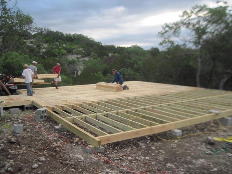

  I built a 24x32 with a 16x32 covered porch. We used 2x8's for the outer base and 2x8's for the beams with 2x6's for the joists.
  I over-engineer everything ;)
  The key will be, if you want stability...lack of that 'creaking sound', easy to find places to put in a screw (lol).. the further you run the joists, the farther you spread them out, the heavier the board.
  So, 2x6's are plenty fine, just keep them at..what experts (people like Mnt know more of the numbers).. under 9ft run and under 2' spacing?
  I went with a 7.5' run and spaced them all like 18" apart.
  I think I have pics... sec..
  Then I leveled them all on cinder blocks.
  It was remote, to say the least. 55 miles from the nearest town and Home Depot told me they would never deliver there again :P
