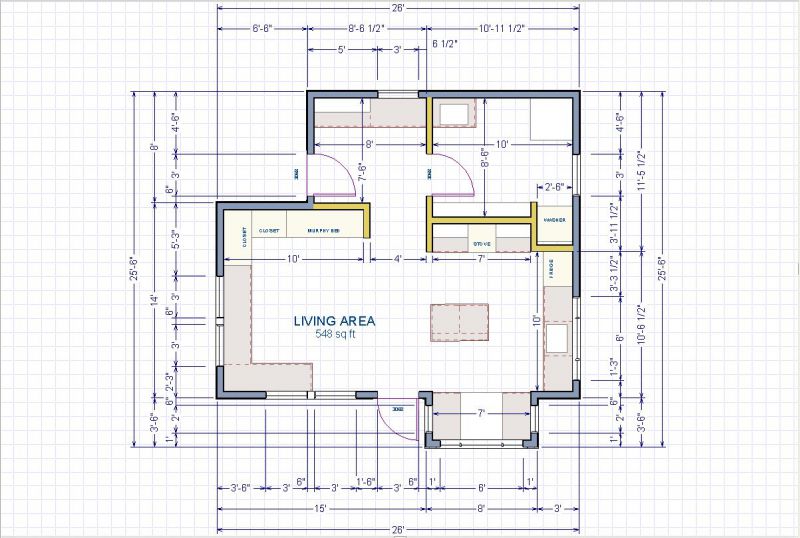

  Here's what I've come up with so far (although I missed my 400 sq foot guideline). Let me know what you think.

# Posted: 29 Mar 2015 08:53pm
  I like the built in eating space in the kitchen...should be very cosy and lots of light.  I also like the flow through the center of the cabin.  Should be good for traffic flow in and through the cabin.
  I don't see any space for a stove.  Wall heater?
  The mudroom and bathroom seem very generous in size for spaces that get used less then 10% of the time.  Might be opportunity to downsize them to get to your 400 sq ft goal.  Or maybe just shift the space allocation from those two rooms to the living space.
  I ike the murphy bed, although having it in the main loving space means putting it up and down every day.  Might get old...
  Just my 3 cents.
# Posted: 30 Mar 2015 06:31pm - Edited by: rockies
  Hi, thanks for your reply. The stove is on the 7 foot long north (top) wall in the kitchen. It is an apartment sized stove (24") between two 30" counters.
  The main space heater will be a wood fired indoor boiler (located in a small out-building) that will provide heat through radiant floor heating and also all the hot water for sinks, shower, washer, etc.
  I've tried to make the bathroom as multi-functional as possible. A 36" square shower, 4' of width for a composting toilet, and a larger than average vanity on the north wall, plus room for linen storage and the washer on the south wall.
  The mudroom will have hanging hooks for coats next to the window, and there are drawers for shoes under a seating bench. There will also be a small cabinet for keys, papers, etc next to the bench.
  I think having a Murphy bed will be easier than either a separate bedroom or a loft. I do agree that having a special area for something that is only used when you are asleep is wasteful. With a Murphy bed you just fold it down at night and up in the morning. Shouldn't take more than a minute.
  Hopefully it all works.
# Posted: 30 Mar 2015 08:18pm
  The advantage to a box is that you get the most square footage for the money. If you don't want it to look like a trapper hut focus on attractive finish materials.
  One thing I don't see mentioned above is a water heater. Don't let that be an afterthought, plan its location carefully and dedicate a closet to it if necessary. Put in a proper flu and gas piping and protect against freezing. A well designed water heater installation equals happy wife.

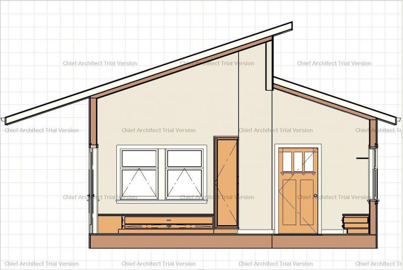

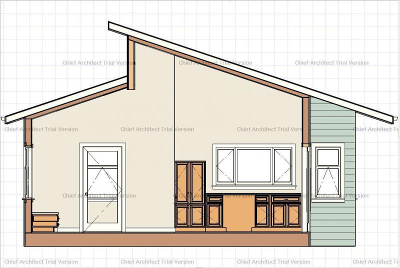

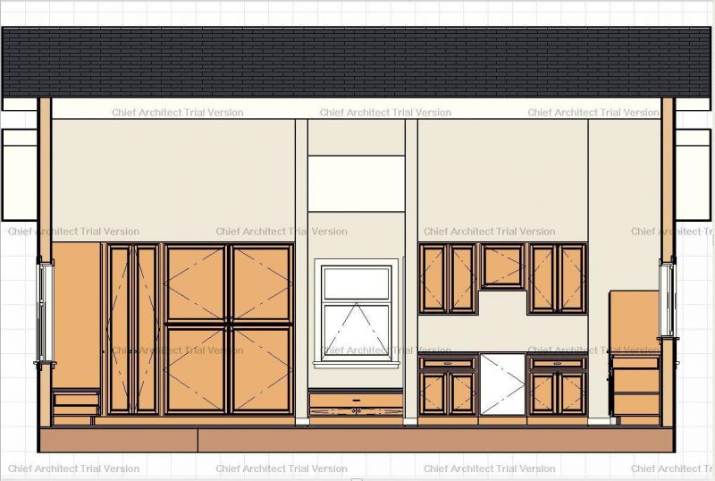

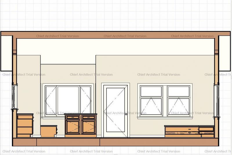

  Here are some sections of the cabin I'm designing.  Looking East
  |   Looking North
  |   Looking South
  |   Looking West

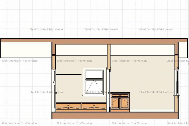

# Posted: 31 Mar 2015 04:29pm
  Here is a section through the Bathroom and Mudroom

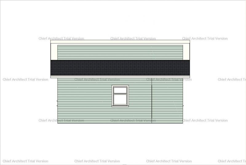

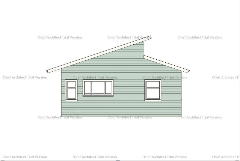

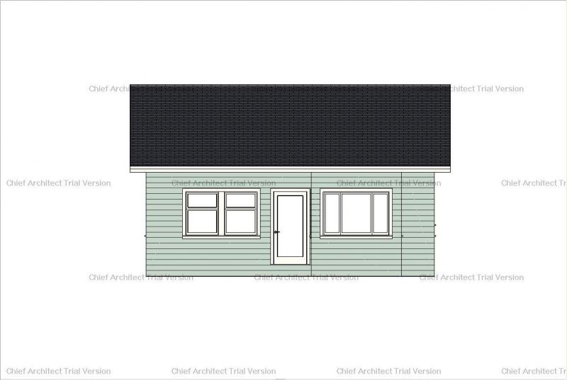

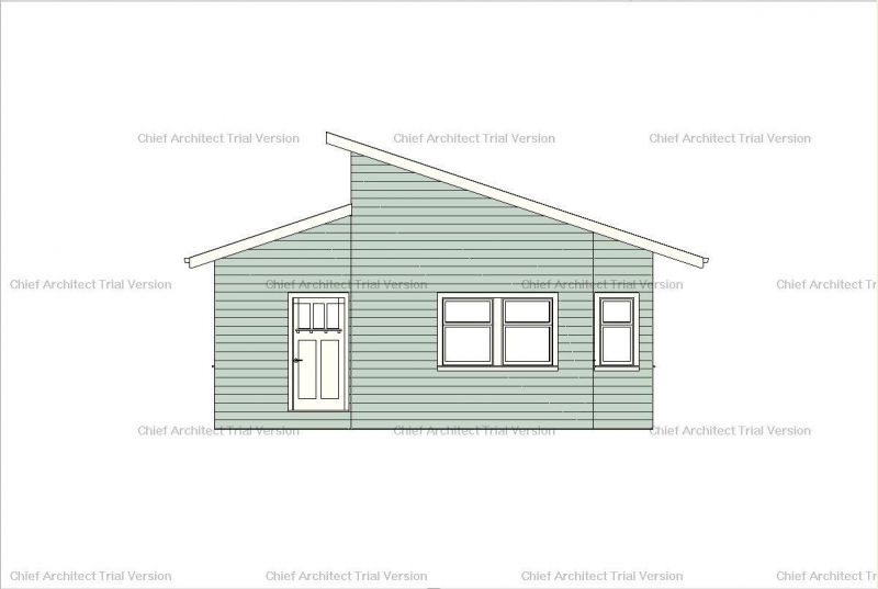

  Here are the exterior Elevations  East Elev
  |   North Elev
  |   West Elev
  |   South Elev

  By having the mudroom and bathroom in a "shed" style addition on the north side of the main room, the differing roof heights break up the typical look of a small cabin (one big gable running along the entire length of the cabin or one wide shed roof running across it). I think this roof style would also be a relatively cheap way of framing in the spaces as well.
  The nice thing is that the main body of the cabin could be built at one time and the  mudroom/bathroom added later on.

# Posted: 31 Mar 2015 09:33pm
  I would put some transom windows in the short vertical wall between the roof surfaces to act as skylights.  Would really add some light to the interior, even if on the north wall.

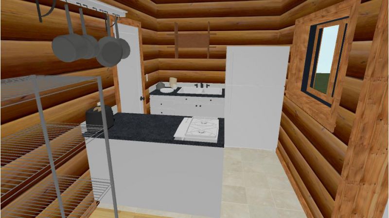

  Here's a small cabin interior that is probably about the same size , but was thoughtfully planned. Everything has a place, and there isn't a lot of space needed.

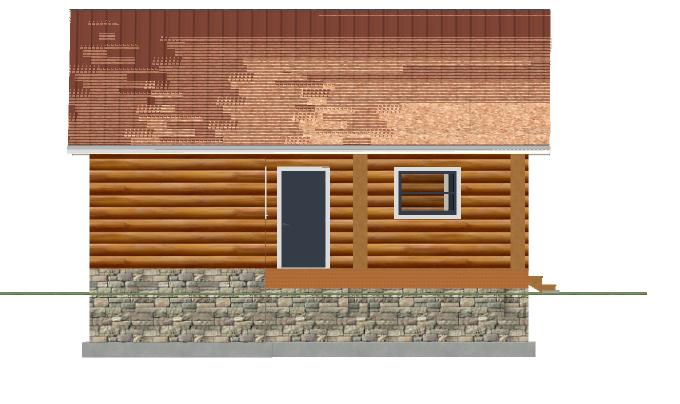

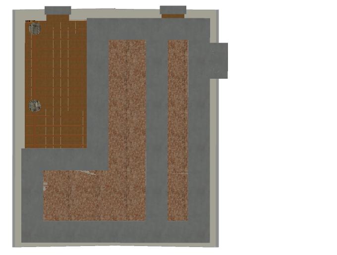

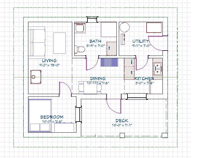

  This is what I am working on. Will be built next year. 606 sq ft with room for everything including plumbing electrical and storage. NONE of your plans have any room for mechanicals. Cost.... about 5k for roof plumbing and miss. Logs to be cut on property.  floor plan
  |   kitchen
  |   elev south
  |   foundation

  Felineman, it's true, my cabin plans do not show any utility room. I am using a wood fired indoor boiler which will be in a small outbuilding about 20 feet away from the main cabin. It will heat the water for the radiant floor heating and all the hot water for the shower, sinks, washer. Piping will run underground to the main cabin (which is on piers).
  In truth, I hate utility rooms in a very small space. All that square footage sitting mostly unused in a corner of a small building ! In a city house those functions would most normally be in a basement, which would usually also have space for storage, maybe a rec room or a spare bedroom/bathroom, etc. In a cabin in the middle of nowhere you'll probably be building on piers or skids, so no basement.
  Since the boiler is already in a small outbuilding, I will also have extra space out there for a freezer, maybe a cold room, maybe space for a bank of solar power batteries, etc.
  I should probably warn you now that I am an Architect (AAAAH! First warning sign of the snob! lol) That said, I must admit I don't like your plans. It seems a shame to spend so much time, effort and money to build yourself a cabin with so many cramped, chopped up rooms. You seem to be sacrificing a lot of inside potential in order to create a sheltered front porch.
  When in doubt, always design a house from the perspective of "Where is the sun during the day"? Ideally, the kitchen and bedroom should be on the east side for the morning light, the dining space should get sun in the morning, afternoon and evening, the living space in the afternoon and evening, and the entranceway, bathroom and storage/utility should be on the north side of the house as sort of "insulating spaces" from the cold north winds. I think your living space in particular will be very dark during most of the day (unless a window is missing from the plans), your kitchen is REALLY tight, and your bathroom is not well laid out.
  606 sq' is quite big for a cabin ( 60 sq' bigger than mine) but there is no real sense of "space" in your cabin. I think you should eliminate the porch and add it onto the south side of your cabin under a shallow "shed style" roof all along the south façade. Screen in part of it if you want, and you can add a knee wall on the cold windy side and put up plexiglass panels above it on that side if you want to block the wind. You'll have a much more spacious and useable cabin without that porch eating up so much space.
