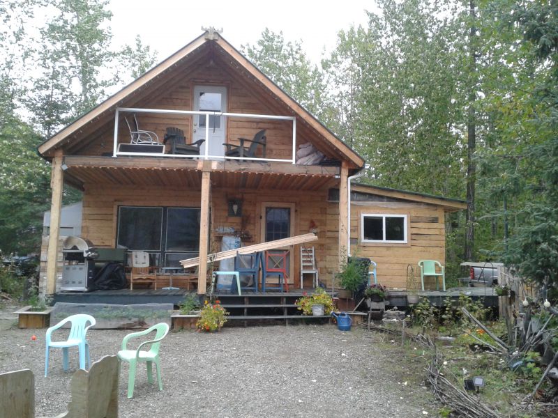

Seems like the work at the cabin is never finished. It is a good thing I enjoy it so much. Last summer we put on a 10'x20' addition for a kitchen and spare bedroom. Things are coming along, always a work in progress.

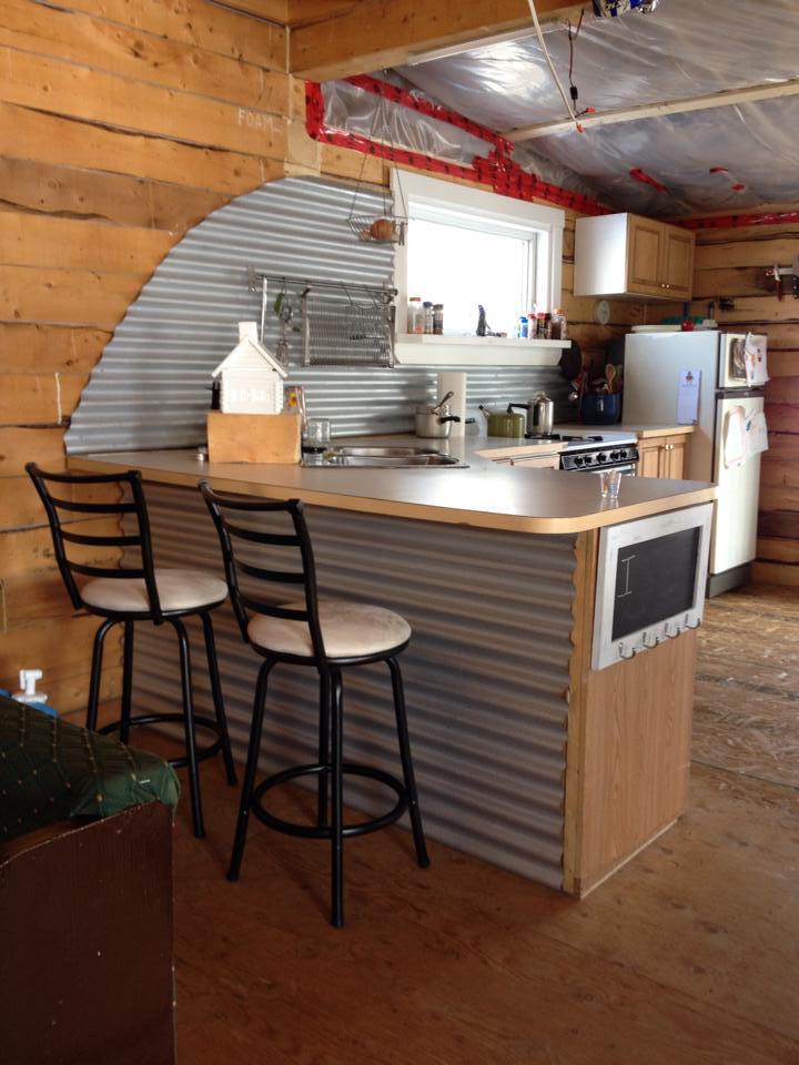

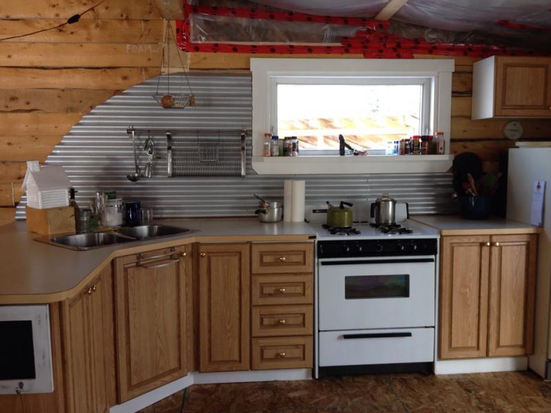

I like the tin as your backsplash....looks like a VINTAGE travel trailer with the window!!!! Great Job on the BUILD!!!

Looking good! I particularly like the balcony. I can see sitting up there on those warm summer evenings, cold one in hand

I concur, nice build! The tin on the back splash and breakfast bar kick wall gives the place a relaxed homey feel.

neat and clean work.. the balcony portion is the one I loved the most. The whole family can have a good evening time there. Kitchen is also very well organized. Great job!!

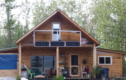

Thank you all for your kind comments. I will keep updating this as we are planning another addition on the left side to match last years. All part of the living at the lake full time plan. This summers addition will contain a spare bedroon and a bathroon/mechanical room. I also plan to mount my solar panels inside the railing of the upper deck, hopefully it won't affect the view to much. If it does, it will require a plan B.
# Posted: 8 Apr 2015 05:39pm
Bear in mind that any shadow falling on solar panels (even just at a corner) can cause the output of electricity to drop dramatically(I read that on a solar power site).
# Posted: 9 Jul 2015 09:10am
great build. how did you cut the tin? I have been putting off a tin job as I'm not looking forward to the cutting. You even have a curved edge. And by it's location I'm guessing it's not too sharp.
and rockies right. You have to avoid shading. Which way is south?

The tin was cut with an angle grinder. It is not fast but if you take your time it works great. South is straight off the deck towards the lake.

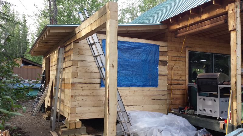

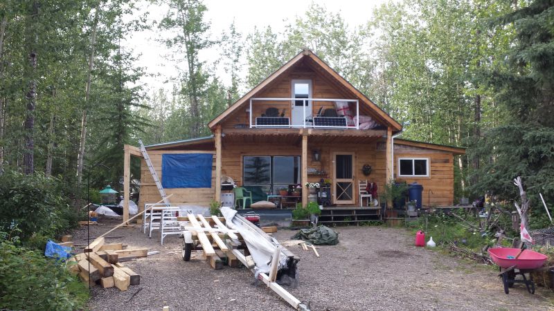

By the way the addition has been added. It still needs windows and finishing but it was all the work we could cram in a week
# Posted: 9 Jul 2015 01:28pm
wow. that looks fantastic. congrats. i really like that extended beam thing.
Ouch. re: south. Have you thought maybe to do a pole mount elsewhere closer to the lake/clearing and run cable to the battery shed? how many/big panels?

thx. oh. and. aahahahahahahaaa. moving lumber with the boat trailer! how I remember the days.

I thought about moving the panels, also thinking about adding wind generation as well. Going to look at a 50' tower tonight. Right now i have 2 100 watt panels, going to add a third.

The boat trailer worked perfect for hauling 6"x6" logs from the pile with the ATV and as a cutting bench.
I am going to put up 8' of suntuff panels on that extended beam. Want to still allow for as much natural light as possible.

you know. if it's only 3 small panels. I would think you could hang em off the front of the balcony okay. I was thinking like 250s where they get pretty big. and well. your place looks so nice. not sure if a big black bar would suit.

Creeky, cutting the tin with a skill saw does leave jagged edges. It is quick and easy however so I do use the metal cut off blades when I know the cut end will be hidden (I can prime the exposed metal & cover it). If the cut end will be exposed tin snips or electric tinsnips work best as they pinch the metal folding the painted ends back over the cut and exposed metal.
The clean looking radius cut definately took a ton of patience. Little Salmon is my hero! 👍
