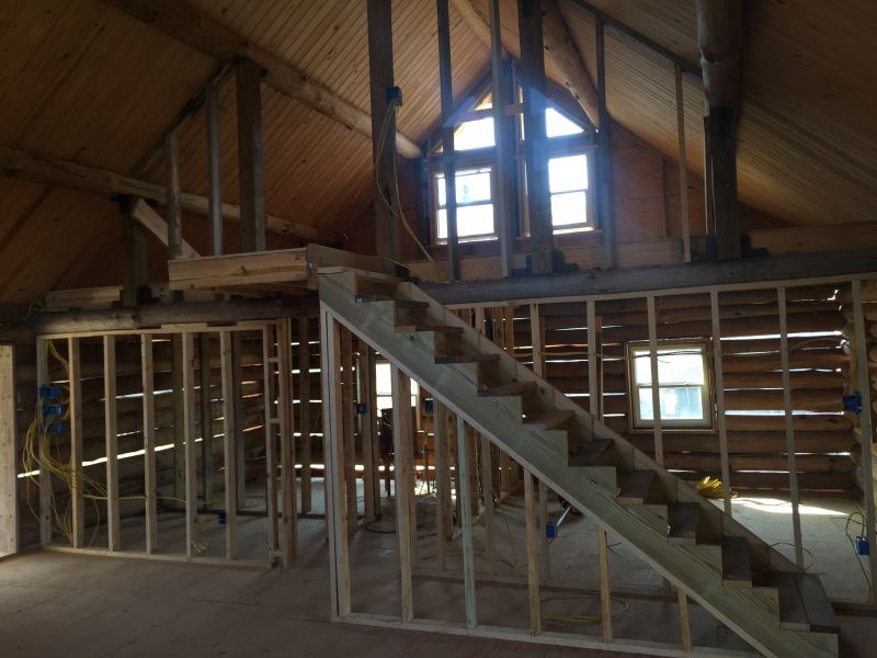

Malamute
# Posted: 17 Apr 2015 11:07am - Edited by: Malamute
  How dry are your logs? It looks like the interior walls are framed with no settling room under the tie log going across the room. Usually some settling room is left so the settling of the walls from the logs drying doesnt crush the floors and make doors hang up.
   I finished a place that had factory milled logs, supposedly dry, that was framed without settling room. It ended up causing serious problems.
   Its usual to attach the interior frame walls to the log walls in ways that allow settling also.
   It looks like the window jambs/frames dont have settling room also. The top of the frame touches the log above it. Are the logs on the sides of the frames just nailed to the frames?
   You may luck out, but I've seen and heard of many serious issues from not leaving setting room. Very small cabins with very dry logs may get by.
Simpleman
# Posted: 17 Apr 2015 12:20pm
  Hey Malamute,
  I started cutting and peeling my logs in Dec of 2011 and finished in March of 2012. I didn't start construction of cabin wall until around January of 2013. To date the logs have been drying a little over 4 years.  From my research most log shrinkage will occur the first 1.5 years but can shrink up to 5 years. Luckily I have not seen any evidence of shrinking. Work on the loft project referring to 2nd story is approx 7 months old so logs were approx 3 years cut when I started that project.  Also the diameter of the logs avg 9" to 10".  Shrinkage has definately been a concern of mine but have had no problems thus far.  Windows have been in about a 1 year and I have no problem opening or closing.  My hope is most or all shrinking has taken place.
  Yes, the window frames are screwd into logs.

Malamute
# Posted: 17 Apr 2015 01:40pm
  I like wood and have no issue with an all wood house. To me, drywall and other modern materials detract from log cabins. Guess others have different opinions, as many do things differently.
   If it hasnt happened yet, you may be OK. Your place isnt really big either, or the walls real tall.
   I've had some noticable shrinkage from dead standing logs (I believe several years dead before being cut), and after being peeled and built for a couple years. It wasnt a lot, but I compensated for it. It may not have caused troubles, but was noticable. The chinking around the door and some windows was stretched and tore. The frames were set to 2x4 splines inlet into the logs. I also tightend up the all-thread some going through the walls.
