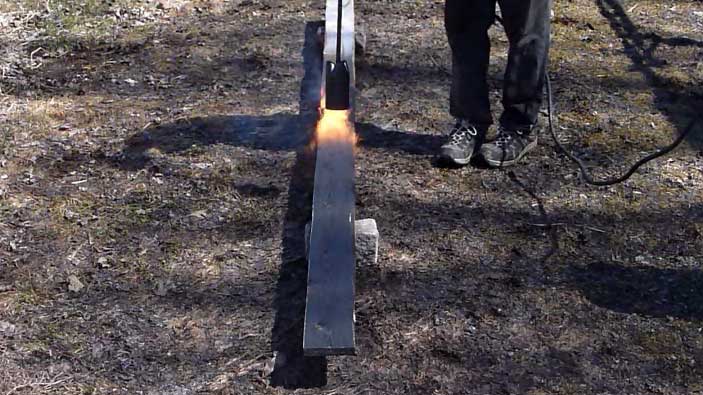

  Following my bokashi experiment. i finally get to making some Shou Sugi Ban siding tests.
  https://youtu.be/53hpkGN_wtQ
  is the video I made.

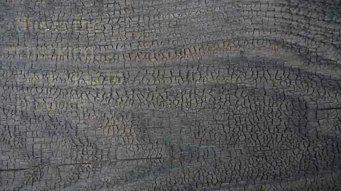

  The process is slow. But after seeing some siding that was made quickly ... it mottles and you have to be careful to get the board fully charred.

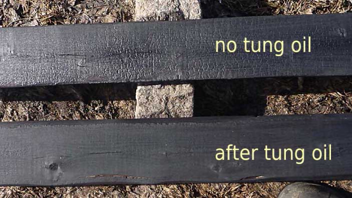

  I prefer the boards that I applied Tung oil to for two reasons. One is that the black is amazing. Like interstellar black. Just black with infinite depth. And two; it doesn't rub off on you.  shousugibanc04.jpg

  That looks really good Creeky !  Can't wait to see it on your latest cabin.  I am curious however, are you not supposed to do all sides of the boards ?  The Tung oiled finish does look nicer in the pics.
  Gee, now you made me wonder if an old BBQ could be hacked up and used as a pass-through burner for the wood...  couple of saw horses on each end and slide the wood through at an even pace to get an even burn.

  Thx. I'm using it for accents. It does look good up.
  The videos I saw online from Japan only did one side. I did the board edges as I saw some not so attractive installs and noticed part of that was raw edges.

  What a difference the oiled finish makes.  Looks great.

  thanks pookie. it makes a real difference in cost too. Two boards drank 10 bucks worth of Tung Oil. I'm gonna need me a cheaper price on that stuff for sure.
  But i've got it up framing the door on the chalet/winter bedroom and it looks amazing. tho. might be some bias there.
# Posted: 21 Apr 2015 03:59pm
  Oh. and steve. different parts of the board cooked at different temps. knots took a lot more time. so unless you're going for a real deep char I think you're better off being able to see the burn.
