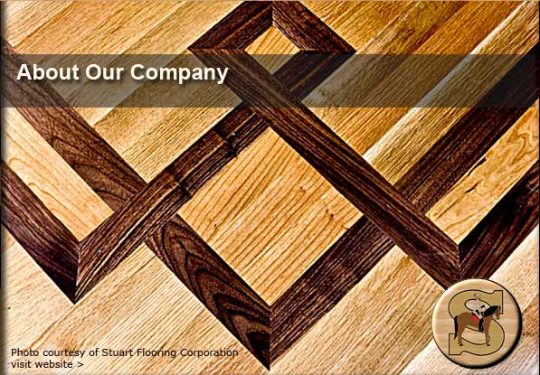

That'll work, I'd lean towards 15lb tarpaper across the studs as a black, breathable air barrier. If you do it over osb or ply you can run patterns that don't depend on hitting framing, yeah she wouldn't let me do the Bud Clydesdales on the ceiling in hardwoods either. Attached is a pic of two patterns that were done in flooring but could be done on any flat surface, this is some of the kind of pattern work you could do over a solid surface. That logo of JEB Stuart on his horse is in the floor of the company lobby, nice workmanship.
