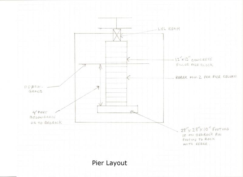

Hi. New to this site and hoping someone can help. I want to enlarge a 7x11 bedroom in my cabin by 5' to 11x12. I have a licensed builder who I have used before. He's great on building not so quick on paperwork. Am trying to get a building permit and am doing the drawings myself. Don't know how to represent the 42" required footings on the drawing. Can anyone help? The existing building is on concrete posts or piers or whatever they are called. Thanks. J

Would something like this work for you?

# Posted: 4 Jun 2015 02:54pm
Thank you so much. I'll try this and see. It is certainly more info than I've had before. Jeanne

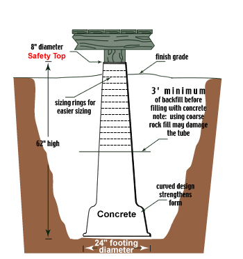

# Posted: 4 Jun 2015 07:22pm
You might try something simpler like this.
http://www.foottube.com/features
footing tube
footing tube
